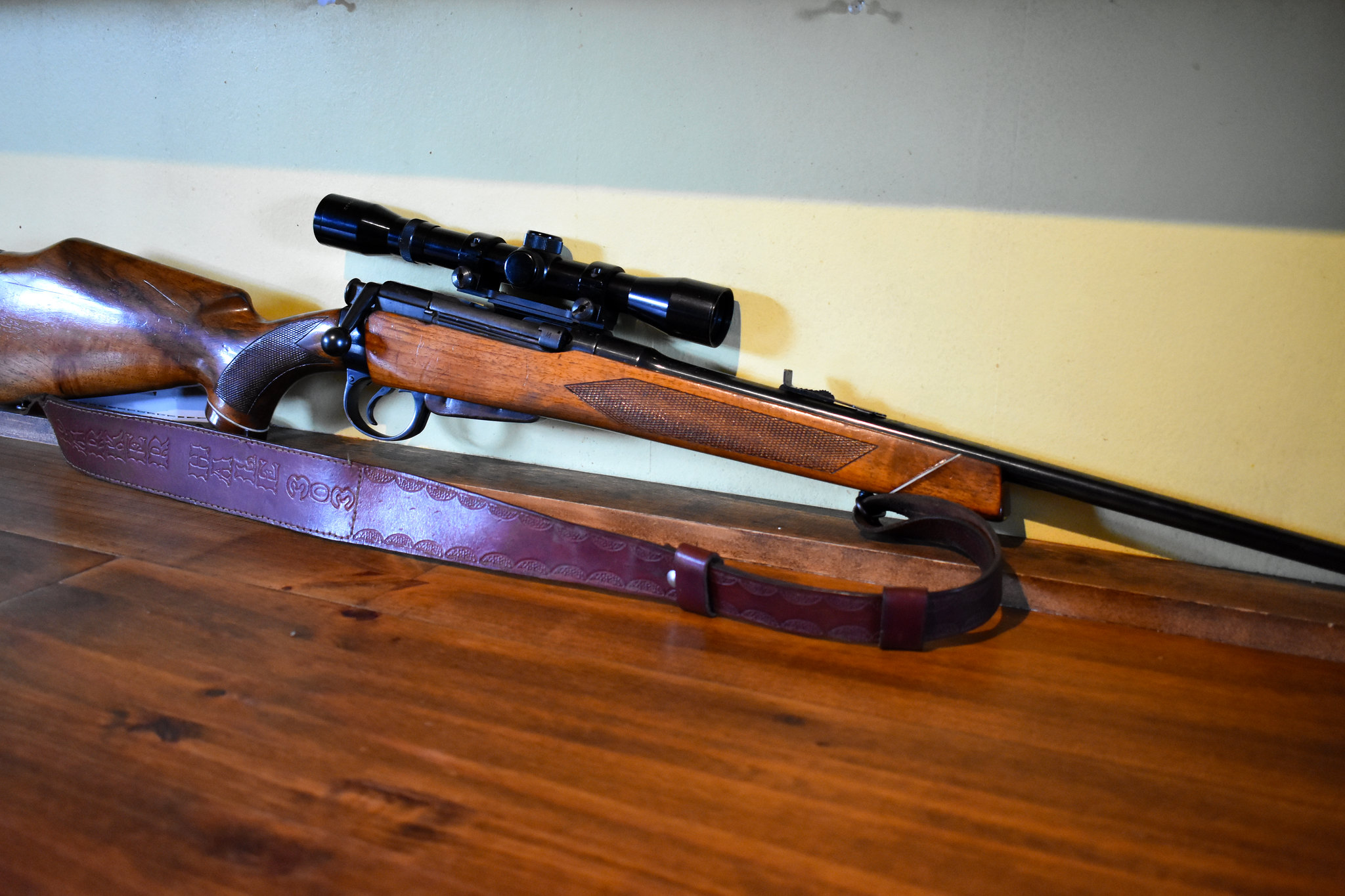

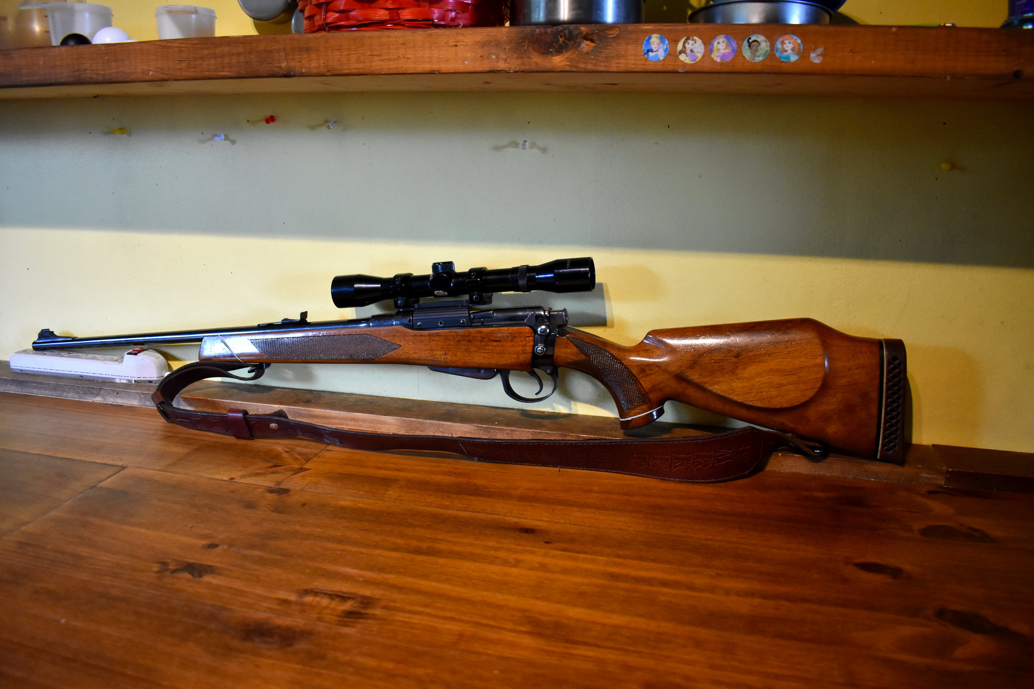

One of my past grandfathers creations, chambered in .303. Its been nearly 30 years since iv shot it, i really should show it some more daylight some day. Feast your eyes
