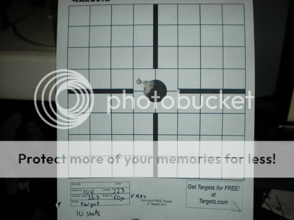

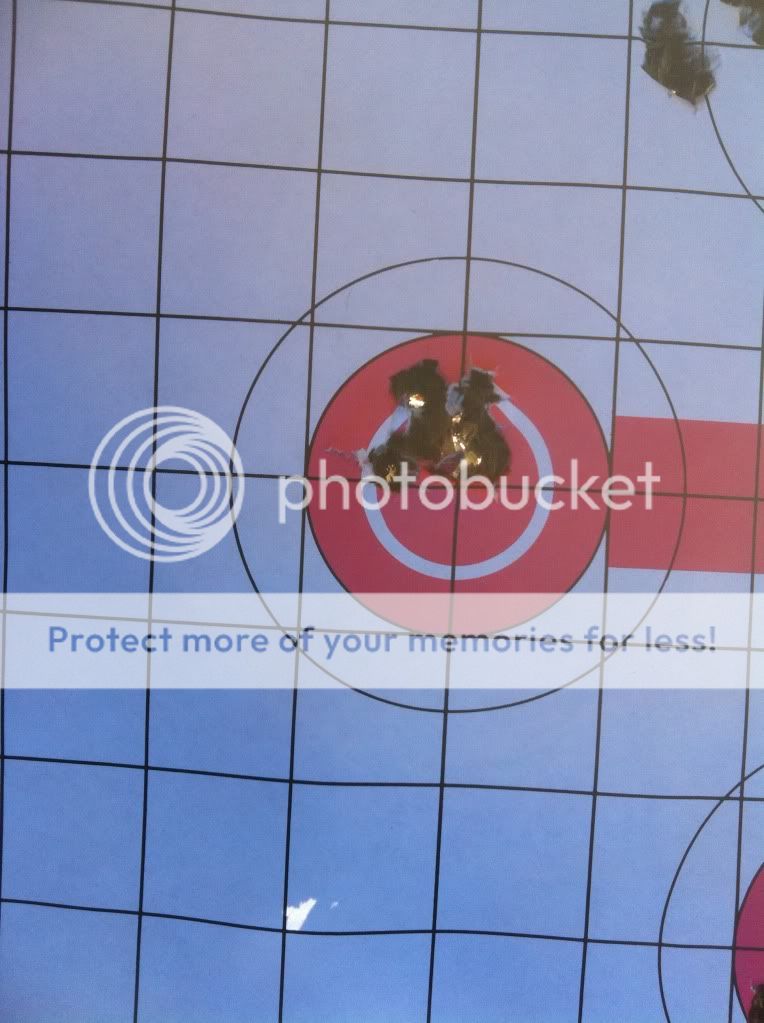

The first part of load development is to determine if a given load has the potential to be a long range performer. If your 100 yard group measures 2" are you going to try it again at 500 or a 1000? I accept the idea that some bullets go to sleep for the first few hundred yards, but I don't wast my time with a 2 MOA load at long range.
A group that stays on an 8.5"X11" target at 1200 yards isn't going to look very impressive when posted, but the half MOA group at 100 that you shot first not only looks good on the net, but tells you, the shooter, that it warrants further attention. Besides, extreme long range groups are not a true measure of the rifle/load's accuracy potential. While it is true that sub MOA accuracy is necessary to shoot a tight group at extended ranges; at those ranges the group is not indicative of what the rifle/load is capable of, it is a measure of what the marksman is capable of. In short range benchrest shooting, the idea is to remove the human element from the shooting to the extent possible, but at extended ranges; it is the human element that makes a tight group possible.
