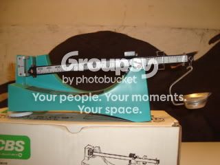

What's wrong with my RCBS scale?

I wonder if the balance point isnt covered with grease or other crap thus not allowing the beam to move freely.
That maybe or the tray and pan are for another scale and causing the problems experienced?

I'm a 58-year-old grampa with lots of shooting experience, but yes, I'm a newb at this. I've loaded lots with a friend with his gear, but I also have been doing a bit with little Lee Loader kits and thought that the addition of a scale would be a good idea. The scale appears to be identical to any I find pictures of with Google images.
Photo of how it looks without the powder tray in place. Note how the beam is all the way down at the left.
When I add the powder tray the beam tips up.
Settings are at zero.
one thing I notice form the pic is the pan holder should face the other way but saying that if that was the cause the scale would be at the top pf the readings.looks like either the pan holder is too light or wrong beam in the scale
It sure doesn't look like the settings are at zero.
It looks like the 1 to 5 grain weight is at about 3.5 grains.
No, I think they are both at zero. The middle poise is square like a hollow box, so it would be easy to think it's a 3.5 or so, but the reading is taken from the right hand bit.
Rugdoc - Not sure if this is something you tried.
Let's look at your second photo. The end of the balance beam is about 1/2" inch higher than the 0 on your scale. When all is good and set, the indicator tip will be directly over the 0.
There's a white rubber wheel under the frame on the left side. From the photo, it's right up against the bottom of the frame. If you twist it, it should screw out, getting further and further away from the frame, if you catch my drift. As it does so, the left end of the frame will naturally rise. As it does so, the tip of the beam will move closer to 0 on the scale.
Distance from the bottom of the scale to the bottom of the adjuster wheel should be just over 3/4 of an inch. Screw the wheel counter clockwise and the end of the balance beam will start to drop.
