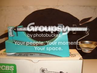

If you look at the picture that the OP posted, the arm looks level, and the scale should be easy to zero, without resorting to playing with the weights in the pan holder.
Well sure it looks level. It's against the top stop!
You could be right,I can't tell for sure from the picture, if it's bottomed hard, or just sitting close to the limit. If he showed a picture with the screw backed way out until the arm was no longer close to level, we could be sure.
The picture blow looked the same with the zero screw in all the way.

The thing is that the levelling foot in the OP's photos is screwed up all the way inside. Moreover, without the pan it's below zero and with the pan it's above zero. Looks like there's room for minor adjustment; could be wrong, but I always prefer to start with the simple options first.
I would clean the knife edges and v-blocks, then place the scale on a solid surface proven to be level, and then try screwing the leveling screw out. If it still can't be zeroed, I would look for obvious damage, as in bent linkages. Only them would I even consider playing with the shot in the pan holder. And if I did adjust the shot, I would be sure to get my hands on a check weight to verify that the scale weighs correctly. If it requires the shot being adjusted, it may have been damaged in a way that could effect it's accuracy.

Sitting the scale on a decent surface other than the top of the box would be a good beginning.
Set all the slides to zero.
Then screw or unscrew the adjusting leg.
Looking at the box top pic the forward adjusting leg needs to be threaded out of the base to zero the scale .the way its adjusted in the pic it will read heavy.
