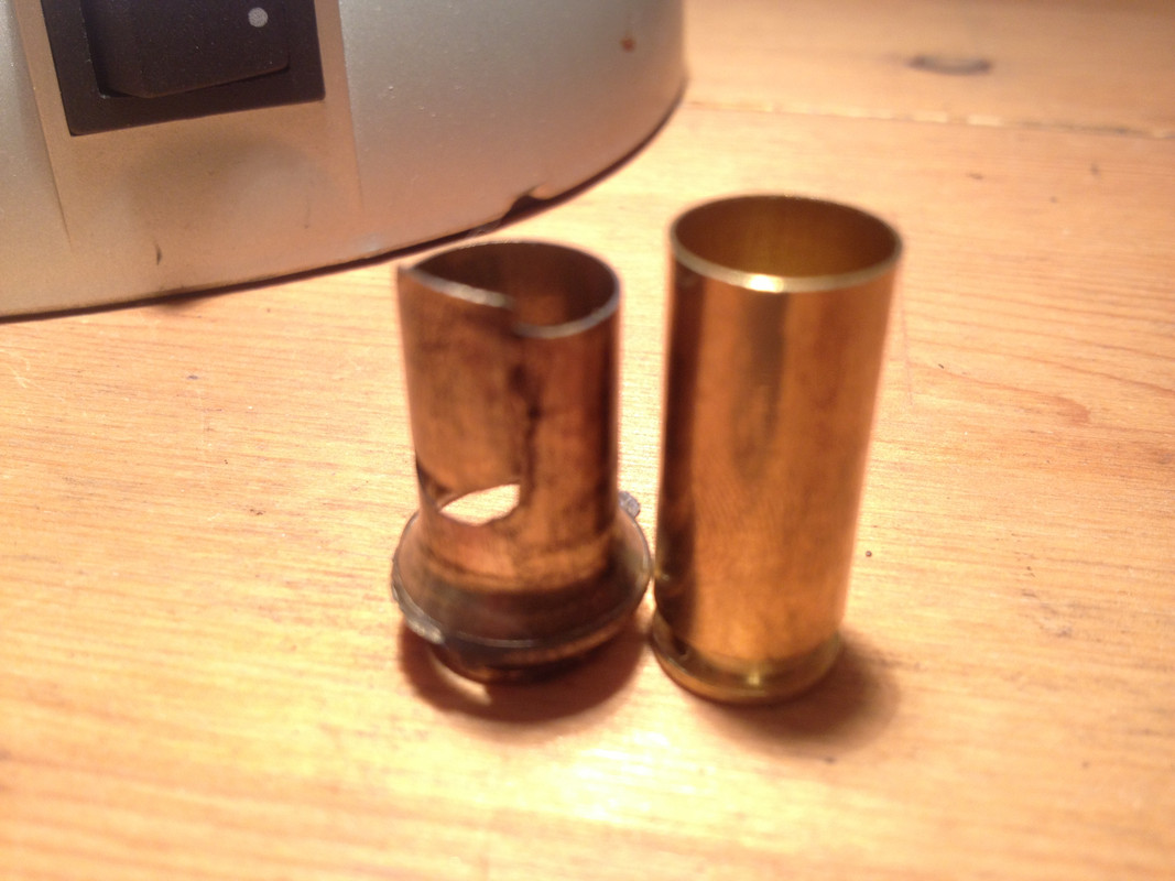

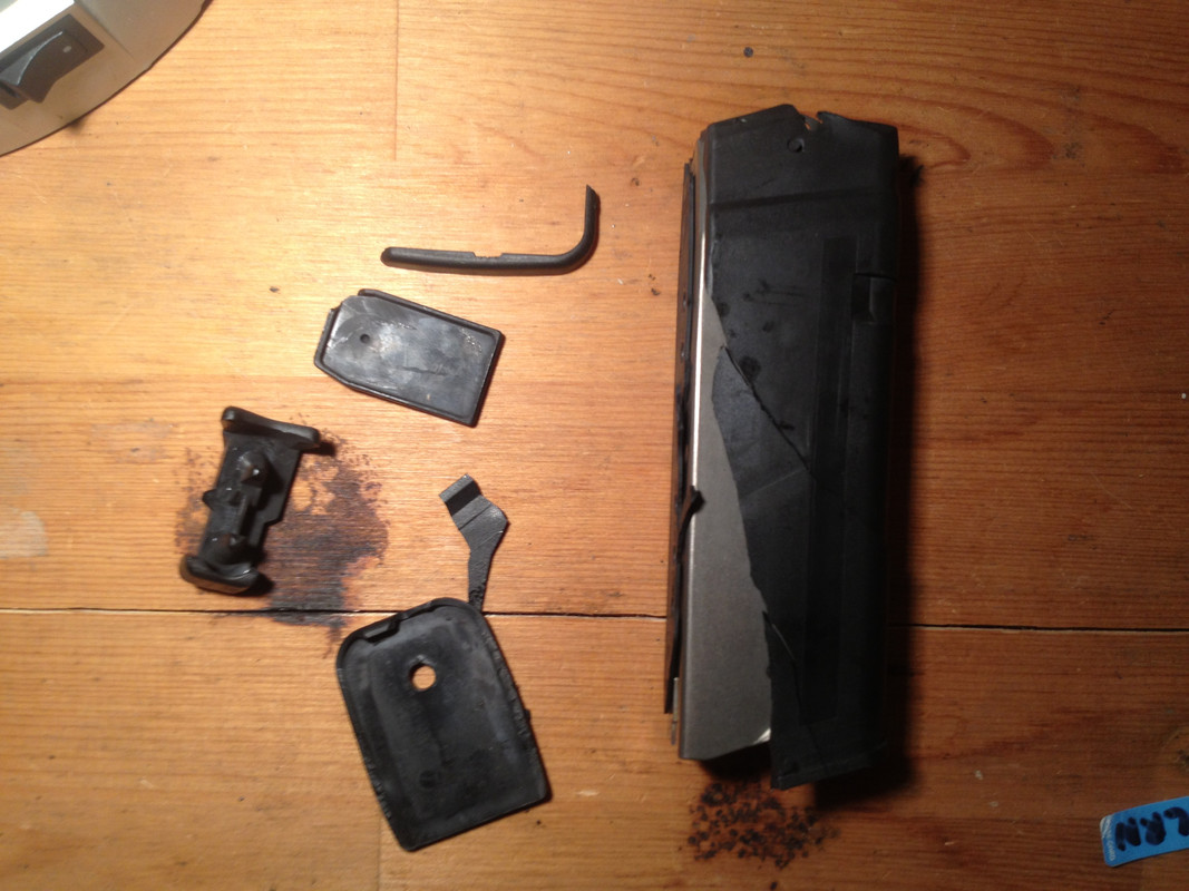

The issue is not to be taken lightly. I have experienced a few kBs throughout the years and none of them were fun. Here is the start of my Thureon Defense journey years ago. You can see how "stiction" caused a funny separation of the case wall after pressure had risen suffiently to stop the case from traveling farther before failing.
