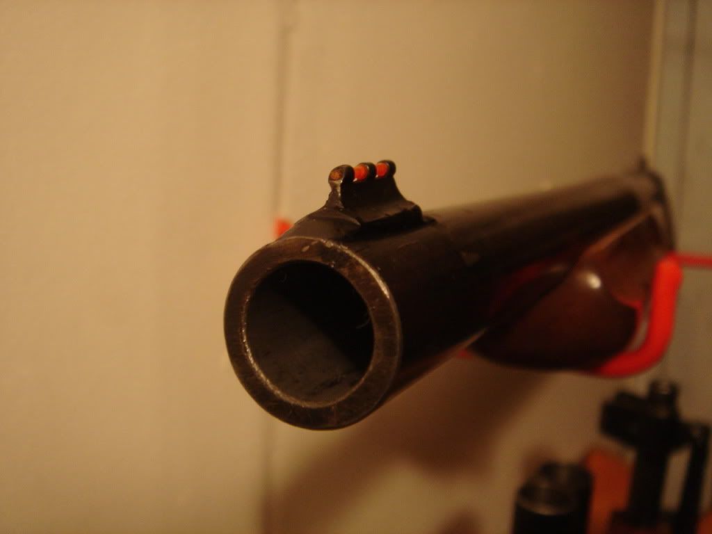

What did you use for a front sight???
I added a fiber optic sight on the front. I actually tacked it on with my little 110. :D I ground the weld into a ramp and blued it with my touch up pen. I think drilling and tapping would be less time consuming and look cleaner - but I wanted to try out a bigger sight. It certainly will stay on!

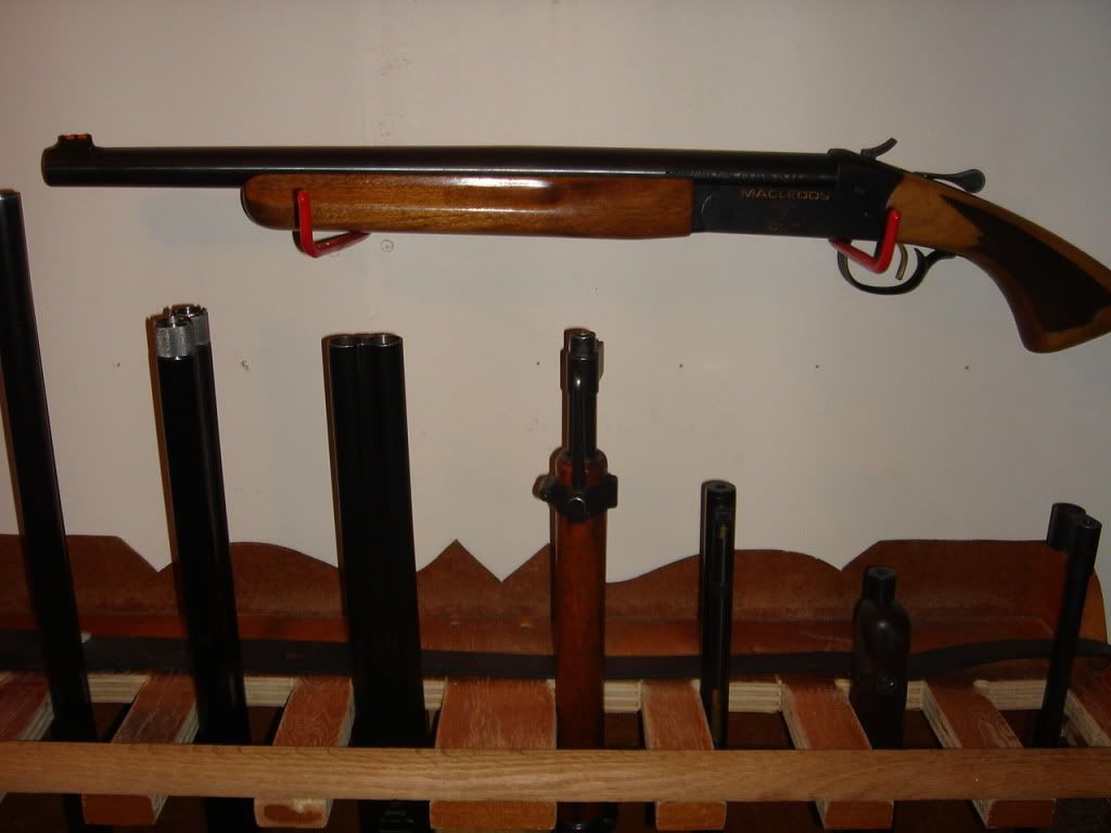

Overall view:
Close up view: (you can tell it's getting used!)
Overall view:
Cool - thanks...
Hey Darrel and cchaban:
Nice work both of you. Great pics cchaban (cool outdoor shot).
Now damn you both. Now I have to go find a 20 gauge to cut down.
Nice work! That turned out great!!! I like the darker stain. Have you tried it out yet?
Yeah, she shoots alright. 16g, so the slugs have a "bit" of kick, but its not to bad with shot. I am having some troubles with the varnish though, not as tough as I would have wanted. What did you use on yours?
