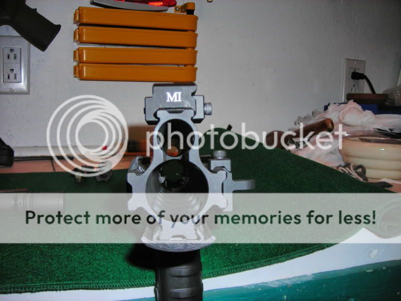

-I can't say its light (3.955kg on the scale). It is front heavy, i'm certain the heavy barrel is in for something. With the Tango Down vertical grip i've added after half an hour of swearing, its a lot more handy now

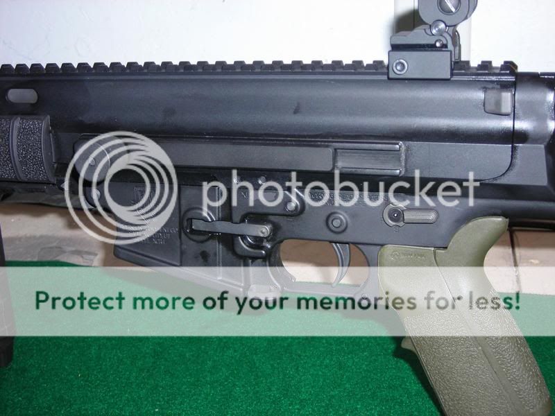

-The selector lever has a 60 degree throws and got a positive feel and audible click.
-The mag catch is the usual fenced and serrated AR-15 type.
-The charging handle: FAL looking, natural position on the left of the upper receiver got a big plastic handle the rest is aluminum with a steel link which contacts the bolt carrier, the handle may be pushed in (means to the right) to act as a forward assist.

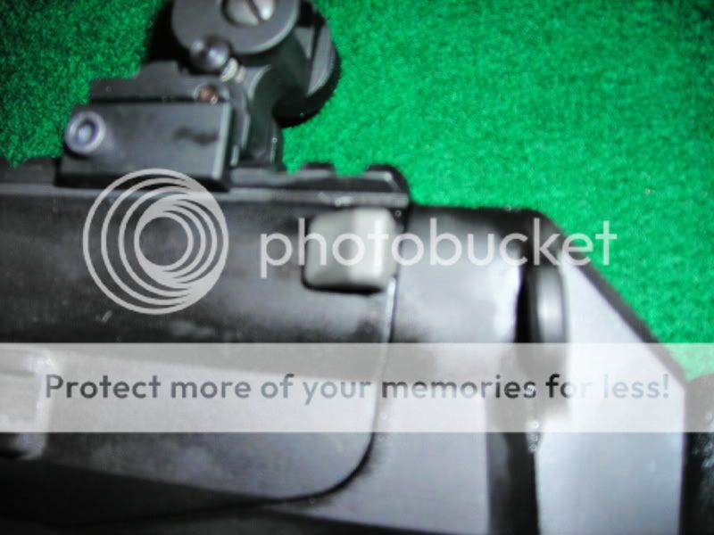

-The bolt catch, THE feature I really love on this gun and many heard about; Its an ambidexious paddle, easy to use with or without gloves, I simply love to put a mag with my left hand and to release the bolt with my trigger finger, very pratical !

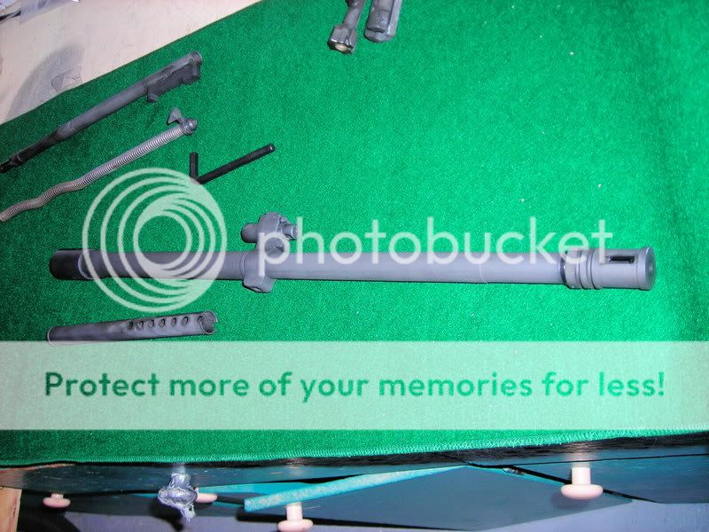

-Gas Regulator: It looks similar to a SVT-40 regulator but uses a spring detent for accurate setting and it can be taken off by the front. It has 6 settings, 5 marked and one unmarked for shutoff. In break-in procedure the gas setting #4, the highest is to be used. When the break-in is complete (200-300 rounds) lower settings such as #3 or #2 maybe used reliably. Settings #1 and S are to be used with sound suppressors which we are unwhorthy to use as the lieberals say. In the operator manual it says it can be ajusted with the cartridge tips (1 on the detent and 1 in the regulator slot) but I've manipulated it with my bare fingers and it works, unless you have very big fingers...
-Trigger: Two-stage, long and heavy first stage and hair-short and crisp second stage, the harder part for me to learn on the gun It should smoothen and lighten with use

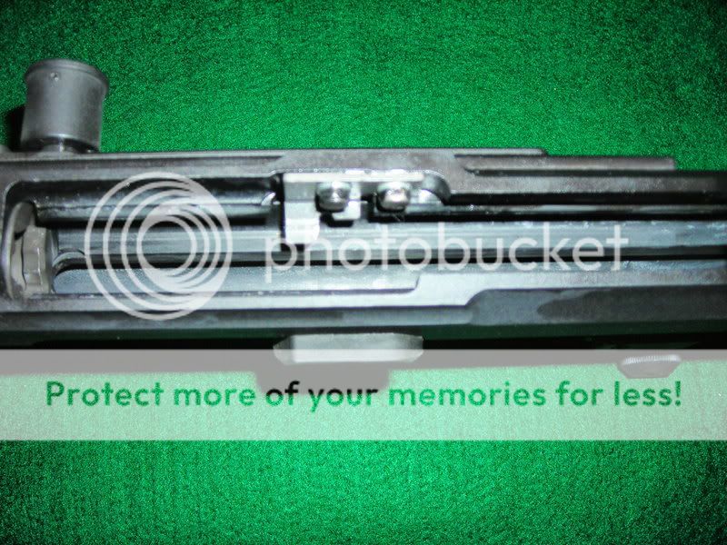

-By pushing the takedown button, it allows the opening of the rifle to access the bolt carrier assembly, the chamber/receiver extention and the trigger group.
-The inside is well finished, the bolt/carrier and operating rod are parkerized.
-The bolt has a BIG face, 3 massive lugs to keep it well locked and a big claw extractor, heavy duty !

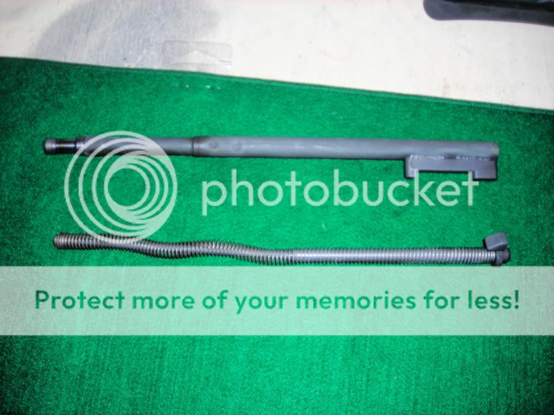

-The bolt carrier has thick walls, there is a raceway for the bolt to cam and to provide one point to fit the operating rod.
-The ejector is of fixed type, 1/16'' thick steel fixed with two bolt and lock washers in the upper receiver.
-The attached gas piston is chromed for easier cleaning
-The buffer assembly slides in the back of the operating rod
-The gas tube has vent holes on one side, usualy it is supposed to be oriented in the direction of the barrel, but I've seen somewhere that if the gun is to be shot in a wet environment the tube should be oriented that the vent holes are facing to the top. Interesting.
