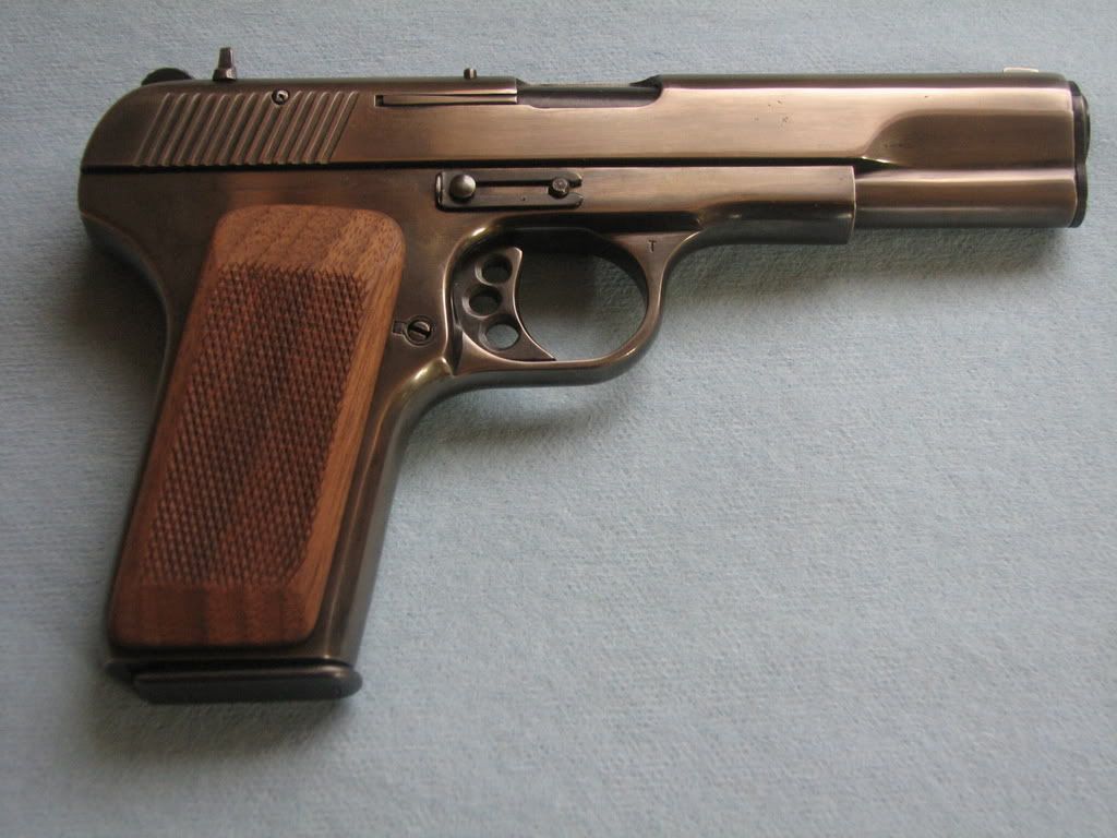

New Norc
I had posted earlier in the thread that I tore mine down and was practicing my refinishing skills before shooting. Here is the final result, more or less. Still have to make the second grip but this was my first crack at checkering and turned out pretty good for a first go at it. My bluing skills could improve somewhat but good enough for this one. The trigger now works smoothly, mags drop out at the push of the release, can rack the slide by hand (although still somewhat stiff). I filed/polished/sanded out all the machining marks and edges, removed the micro ribbing on top of the slide, skeletonized the trigger, smoothed the feed ramp, cleaned up the mag well, and reblued as well as making the new grips. Has been a fun and educational project, just hope it shoots well now.

Where did you get the wooden grips for the above pic's?? Are you handy with wood or?? Looks nice.
I read previous post again stating you made them, could you give a brief overview of how you made the grips ( for the woodworking impaired).
Curious about the skeleton job on the trigger too. How much finesse was involved in that.
SG101, the grips I made myself, just picked up some standard walnut at the local lumberyard, planed down the thickness, traced around the old grip, cut it out and went at it with a small hand plane, sandpaper, and my newly aquired checkering file that I have been wanting to try out. Takes some time but not that hard. The drilling of the trigger was tough, they use good hardened steel in that thing. As far as doing it I just marked where I wanted the holes, drilled with a small bit, then enlarged to the desired size, then chamfered both sides with a large bit. sanded it all smooth then reblued. As far as finesse with any of it goes not that much, did it all at the kitchen table, I am just very patient....lol
Awesome!
Congratulations. Very nicely done.
(Oops, let's edit the right name in my post:) Grwhthntr, nice job!
Noob question - how did you install the grips - did you reuse the same "brackets" that the original grips came with?
Lou
Actually they aren't installed yet, as you can see in the second picture the grip is actually out-of-place a little. I haven't decided exactly how I am going to install them yet but will post a pic when I do.
