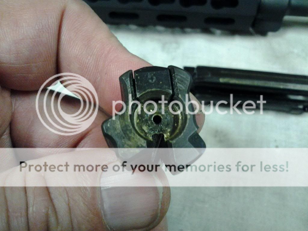

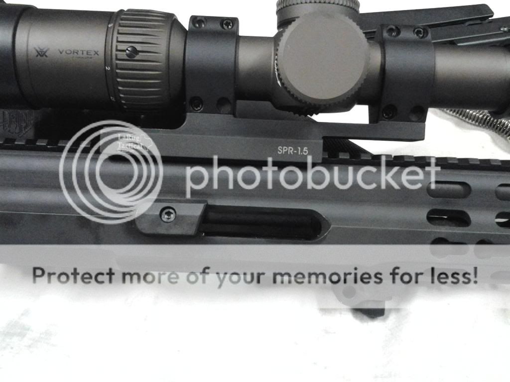

Good deal. Ya seems great on setting 2 when it's going good. But then somthibg happens and a empty will just pop out a foot. What's the length of your delector? And do you have a pic. Also do you have brass residue on the outside edge of your extractor? Does it move easily or is it a bit tough
Extractor is not as bad as the picture makes it. Simple wipe with solvent and it all came off.
Extractor is very tough can't move it with just my fingers. Does move when i use a rod or punch.

Ok so I found a few issues. As for the bendt necks on the brass it's coming from the feed ramp. As for the poor ejection it's from the ejection buffer. I removed it and it ran on 1 no prob. Did send brass at my 4-5 o'clock but no stove piping. I tried to grind down the brass delector but it still did it. Dosnt seem to be any damage to te ejection port so ill leave it for now. I think ill email wolverine with a few pictures.
