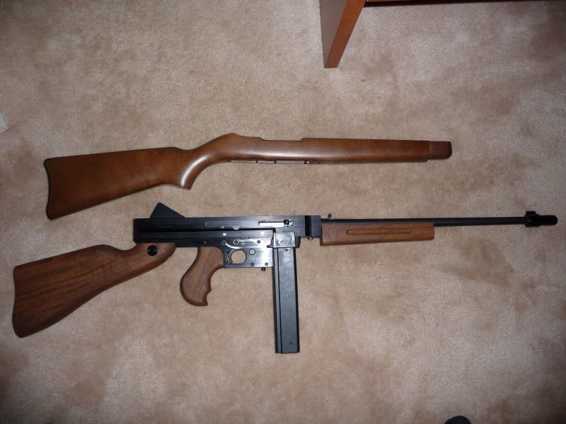

I have finally had time to put mine together and I have to say the end product looks awesome. Now I only need to buy the mag or make one! I have a 11.5 inch barrel on her which is perfect. 33 inches long!

Thank you Johnnylo. :D I am glad you are happy with the final product. I hope everyone who bought a kit will be as pleased with it. Its been a long haul to get it to this point and I have endeavored to make it as flawless as possible. But with all first run products there are little things that we have found that we would like to do better and we will. So it's on to the second run hopefully starting next week.

You've left your sights on the barrel. What's the sight picture like?
Jason
You won't be able to see the rear sight at all. You will need to move it to inside the rear sight cover and then install the front sight post at the front of the receiver for you to be able to do anything other than "spray and pray". On the other hand that's kind of fun too.:p

I finally got to fire mine this weekend. It was so much better than just firing my regular 10-22. No problems at all. The sighting system was not that bad.
The only thing I noticed, which is not major, is that there is an edge that could be ground down by the cocking handle that my big hand hits.

I will look at that area on the receiver and see if we cannot break the edge better on next generation receivers so its not so sharp. I don't notice it on mine as I have a large knob on my cocking handle that looks like what the real Thompson has. It makes cocking the 1022 Thompson soooo.... much easier and it looks and feels more authentic as well.
