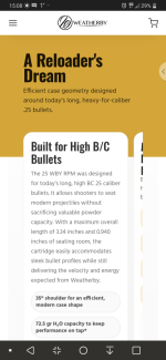

I haven't heard how this cartridge performs with reloaded ammunition. I'll save my opinion till I know how it performs, not by assumptions. If it's close to 257 bee performance there will be no complaints. BTW does anyone know what the case capacity is compared to the weatherby.
An empty 25 RPM case filled to the brim contains right about 10gr less H²0 than a 257wby
