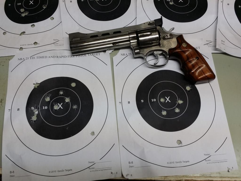

This is a lot harder than I thought it would be. I guess I need to shoot more. It took me at least a hundred rounds of .38 spl before I even had a target that was kind of respectable. Lots of shots not even on paper before the last two. I was going to use my last target on the bottom right as my last target, but the 686 jammed. Whoever said revolvers don't jam is a liar. I didn't figure it out until I got home. I couldn't open the cylinder (all six shots were fired as you can see on the paper) but I had to use a piece of wood to tap it open. Then it wouldn't close, wtf I thought? It took me a half hour to figure it out. I looked at all the parts, nothing broke or out of line, and then I randomly spun the extractor rod clockwise and the extractor went flying about five feet away. So today I got to shoot and learn something about my 686. The extractor rod has left hand threads and if it comes loose, jammo. I will try again next weekend.
