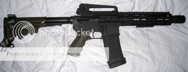

Alriiiiiiight... finally some decent pics of my setup. Not as ###y as Suputin's, but it works...
First - here's the 'rig' as-is, in 5.56x45:
The front sight is going to stay, for now... until I buy another front BUIS. The .300 Fireball is slated to get the YHM front BUIS (just need to bolt it on; will do it before the next range trip) and is presently wearing the Bushmaster carry handle as a rear sight. Eventually the .300 is getting some glass... but finances, as always, win out over desires.

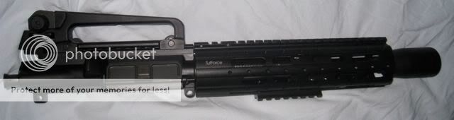

Now - here are the 5.56 and .300 Fireball bits side-by-side:
The .300 Fireball upper alone:

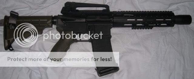

The rest are all .300 Fireball.
Stock extended:
Stock collapsed:

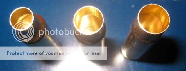

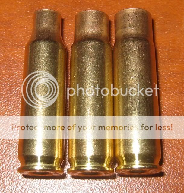

Alright, here are the pics of the three steps, side-by-side:
Left: .221 Fireball, "factory".
Middle: .221" to .284."
Right: Finished .308" neck and full-length sizing.

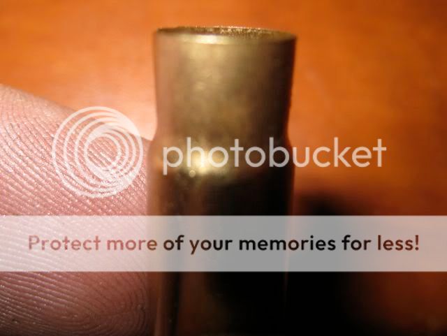

An intentional mid-way stop between the .284" and .308" expansion step - you can see how gentle the taper is.

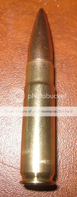

And.... prime it, seat a 147gn ex-M80 ball projectile:
So, that's the process starting with a .221 Fireball.

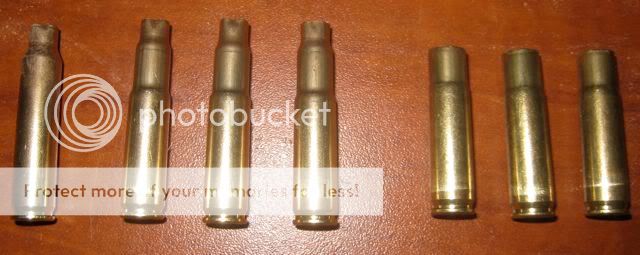

Starting with a .223 or 5.56 case:
I had some .223 cases with dented necks, and just ran them through the .300-221 sizing die with the EXPANDER REMOVED. I can't overstate how important that step is... lol! Good luck trying to toss a .308" expander into a .223 neck without putting some SERIOUS taper on it.
Above, from left:
1 - .223, "as is."
2, 3, 4 - Run through the body portion of the die (no expander)
5, 6, 7 - Pre-cut at the shoulder, then run into the body portion.

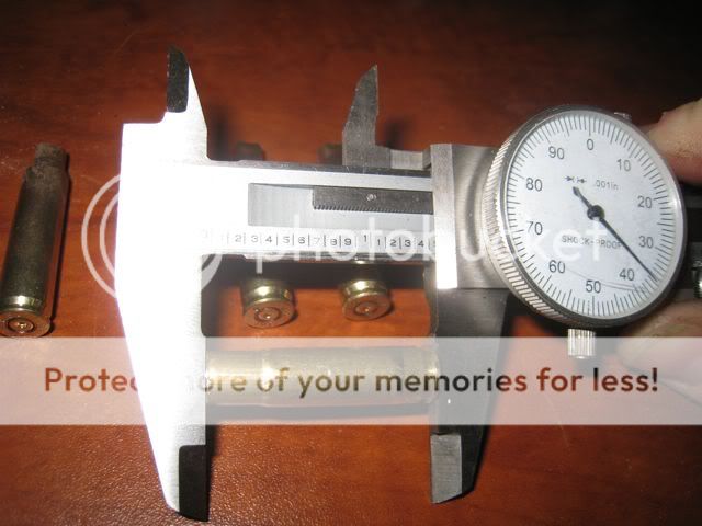

Note that when cutting at the shoulder, I've left 30 to 40 thou of room; the calipers below should read no greater than 1.400" - the trim length of a .221 Fireball, which also goes for a .300 Fireball.
Being that they're at 1.435", I've got about 35 thou to trim - which I would do in an RCBS trimmer.
