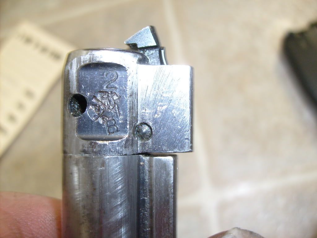

I took mine to the range last weekend, and was disapointed to find it wouldn't fire. I tried two types of ammo, and figured it was hitting the primer too lightly.
It would leave a small dent, but no blammo!
The extractor ( a stock .303) wasn't working at all either.
The round would just drop into the space under the bolt, which required mt to turn the rifle upside down to shake it free.
So, I suppose it is a work in progress.

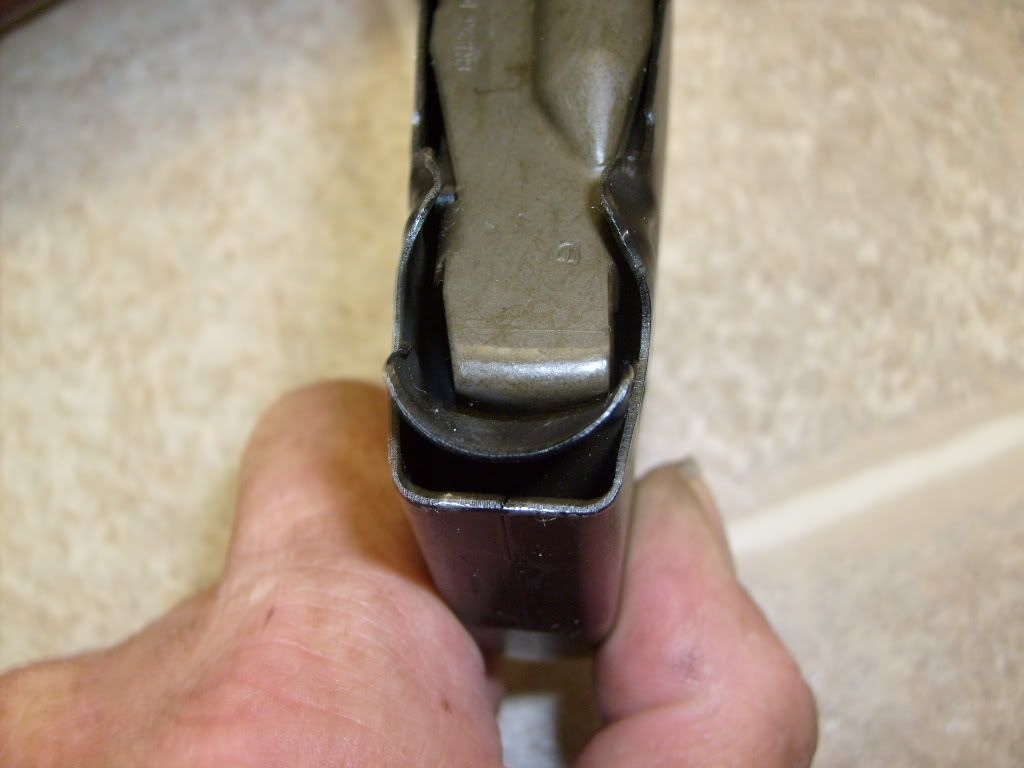

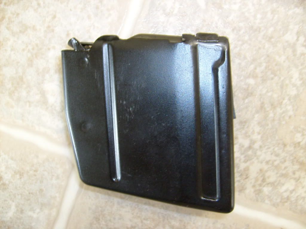

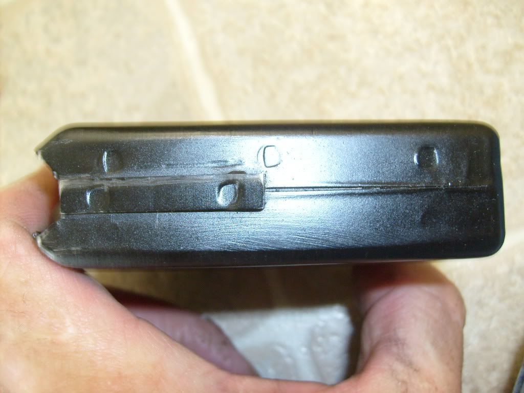

I got a 7.62 enfield mag for it. I will be needing a proper extractor, so if anyone has one, I would appreciate a PM.
Thinking about improving the stock.
Any ideas why it would have a light strike?
I noticed the firing pin has two small grooves worn in it about halfway down.
Is there any way to keep that target triger when using a mag?

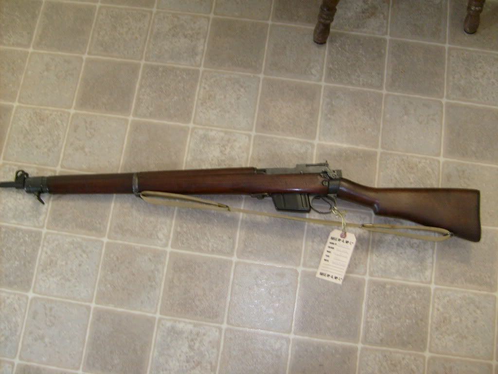

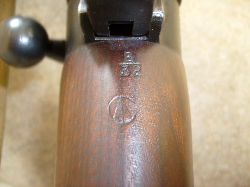

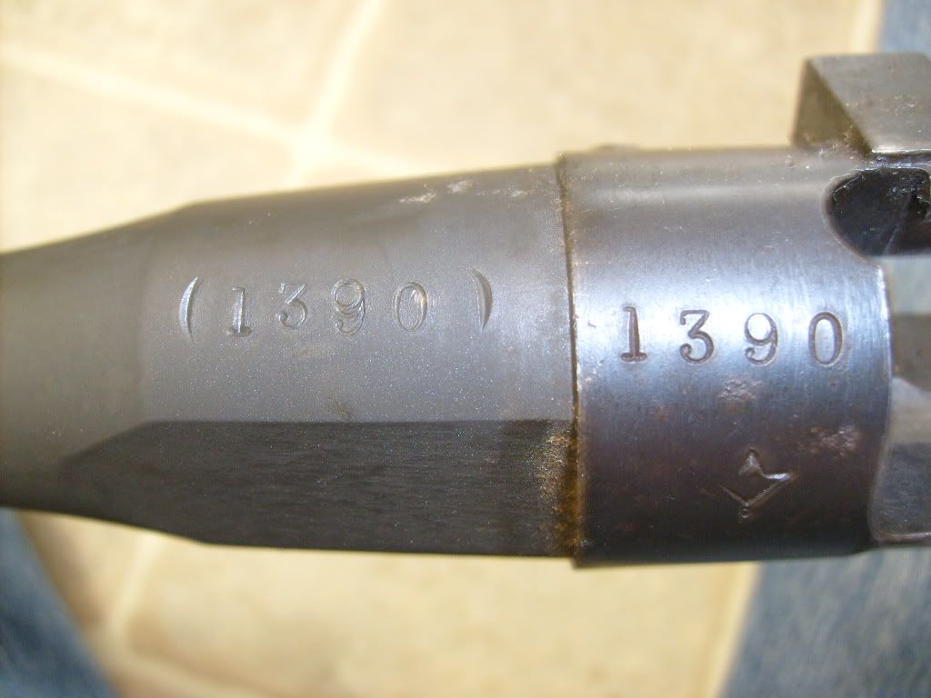

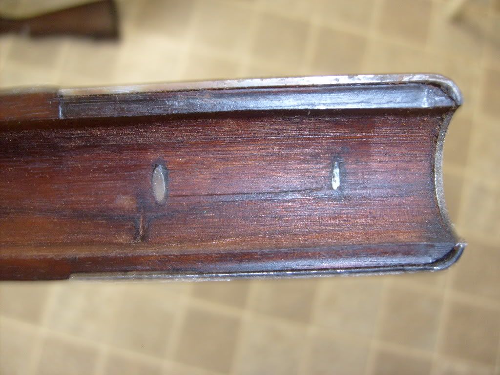

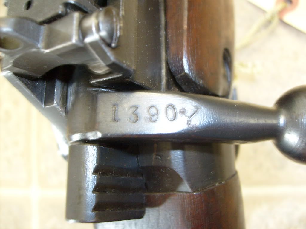

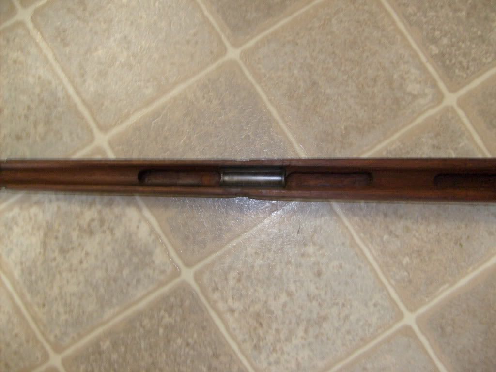

Well here is my second DCRA #4Mk1*.Its number 1390.Enjoy the pics
More pics.Hit the wrong damn button.
Thats about it other then a Parker Hale 5C is on its way.Hasn't been to the range yet as its going a though cleaning and oil soak.
