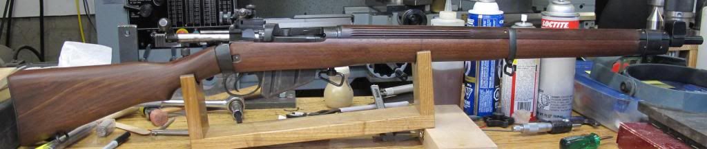

How about a 1943 LB DCRA matching with a new unfired mint barrel, new walnut furniture, all new bands, screws etc. PH 5C, only non LB part is the mag follower. If anyone is interested I can post pics.

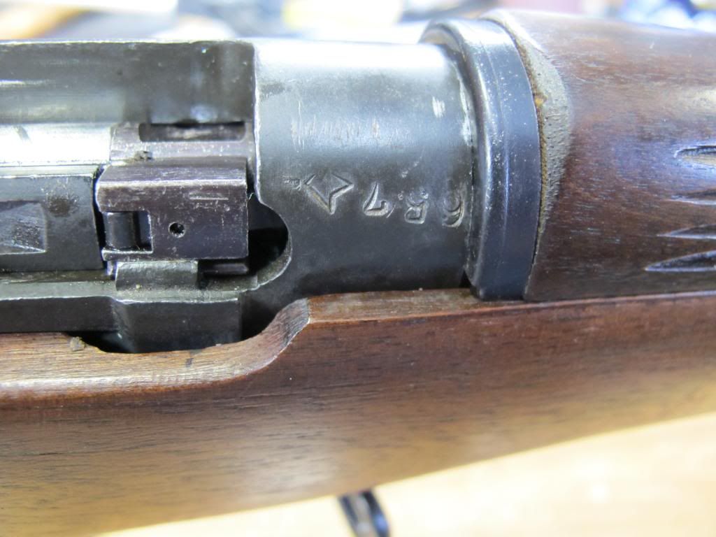

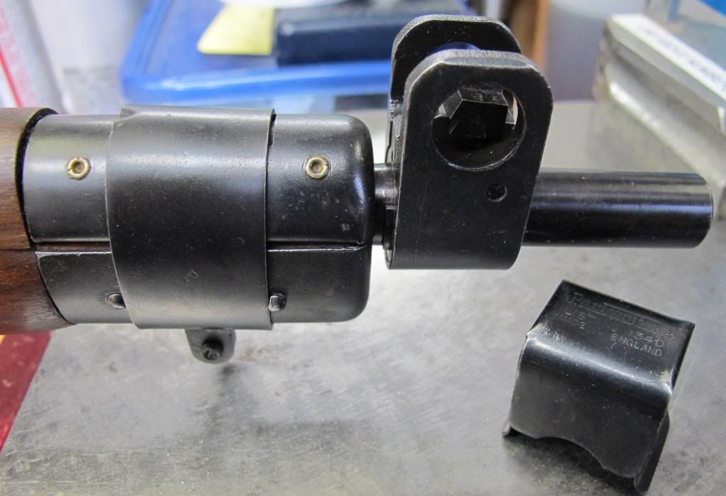

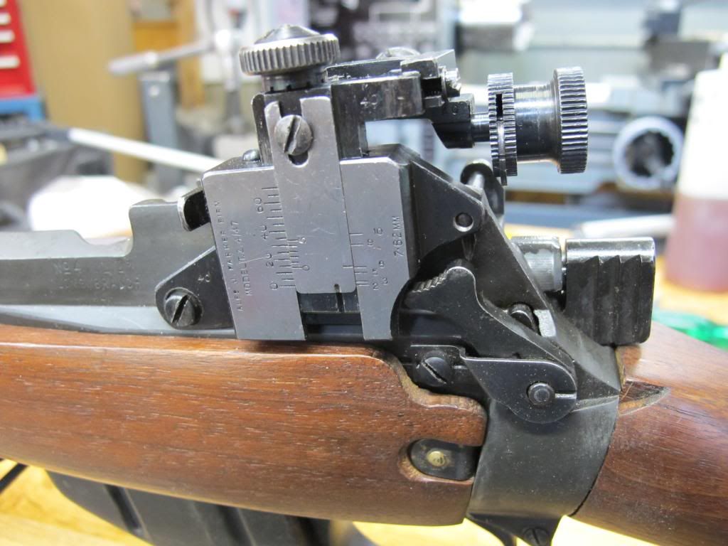

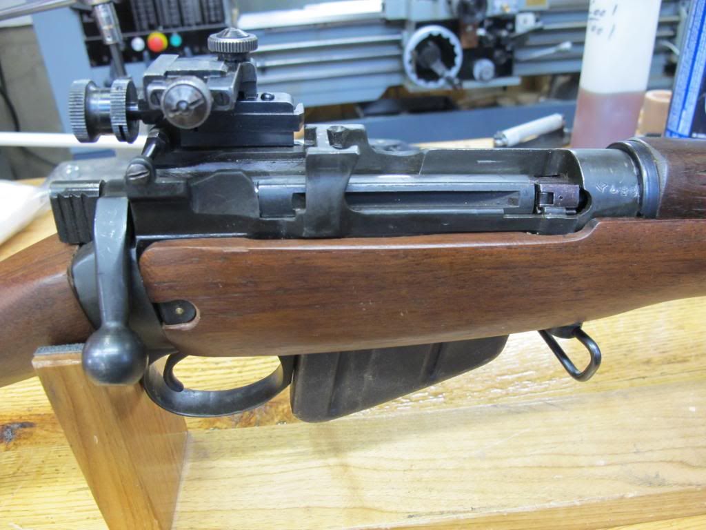

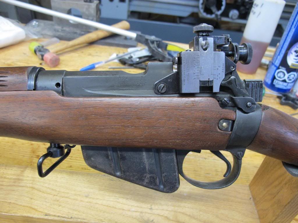

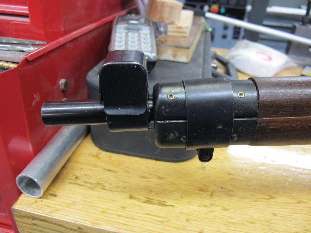

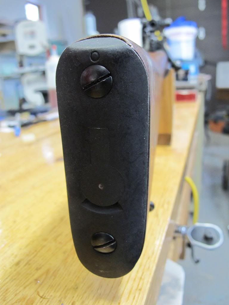

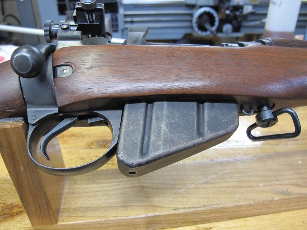

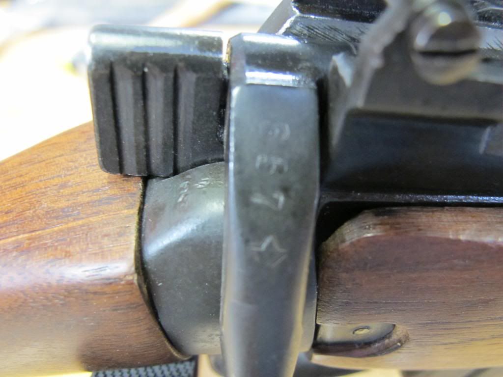

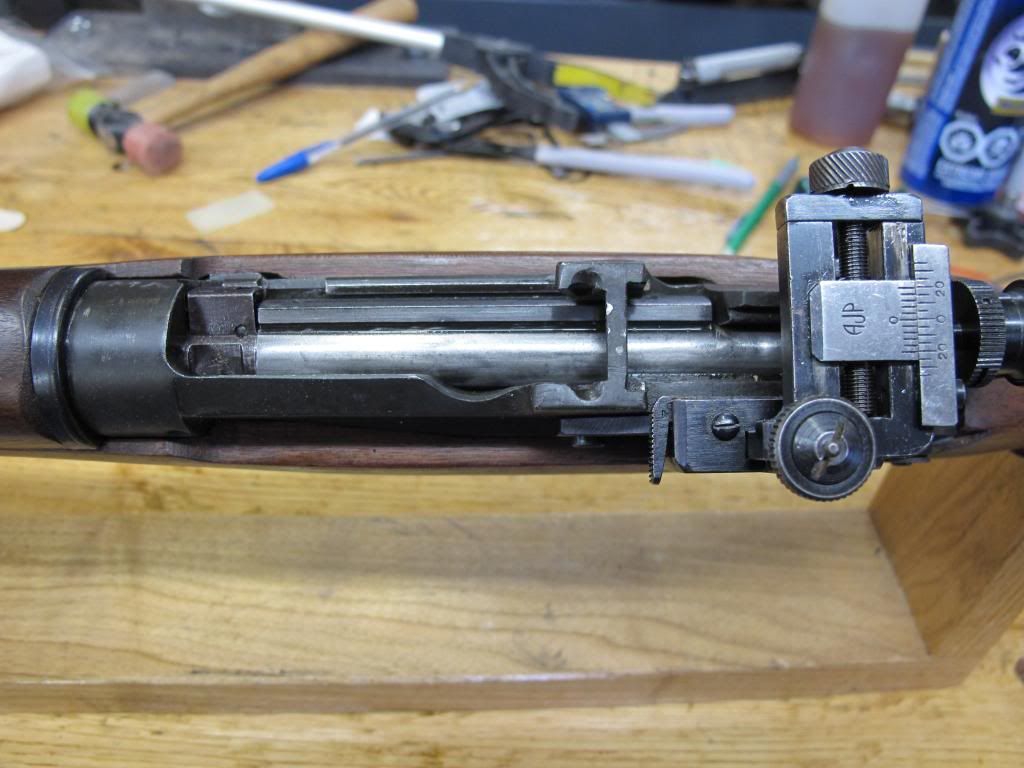

Here it is. I bought a conversion #4 from my club to start. It had wrong wood and a Sportco barrel but action is very good with matching serial and DCRA numbers (657). I have accumulated enough parts to build an unfired conversion. The barrel was new in the white given to me about 35 years ago, the wood and all the parts were unused and are marked LB or CA except for the butt which is only arrow C and the follower. The rear is an AJ with a 7.62 scale although any of these or PH would be correct, the range scale was never used so is irrelevant. The vast majority of the screw were unused. It took me longer than I thought it would to put it together, a good day in total, had to use a breaching washer on the barrel and the unused wood took a bit of fitting in the draws, it is not centre bedded right now. I guess once you have done a few hundred they would go together very quickly. So overall it's as close to new as I could make it, the wood although never on a gun does have some handling marks which I guess is to be expected. I thought this was more fitting than the livery it was wearing.
