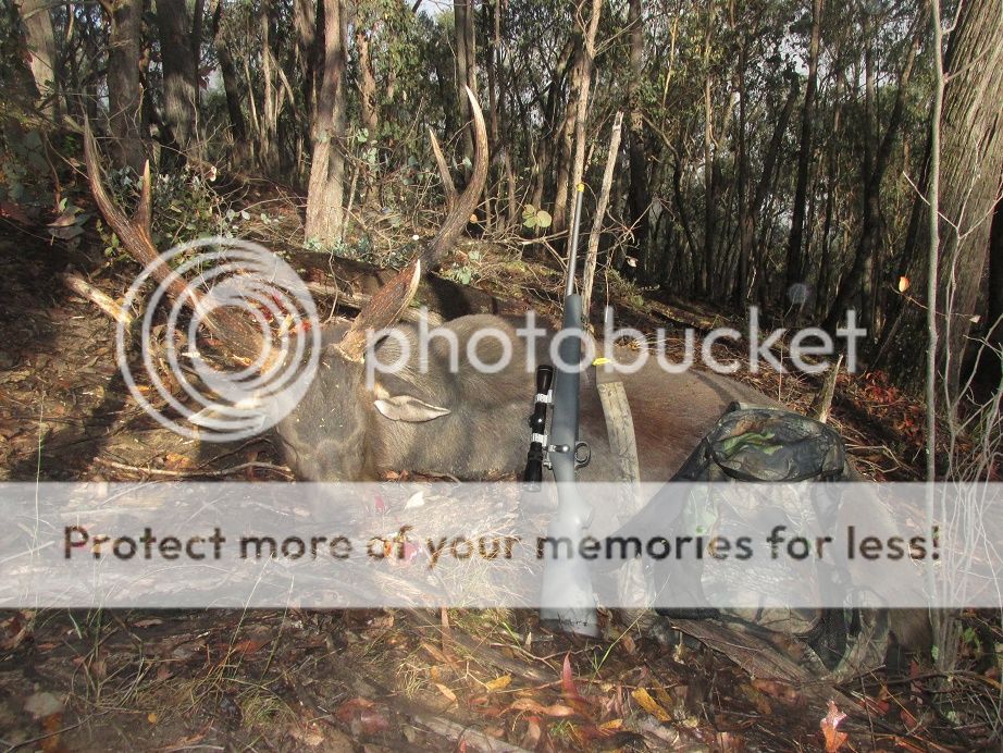

IMG_3075KimberStagBag.jpg~original

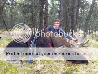

To answer the question: here's my friend's son with his moose and Tikka in 7-08

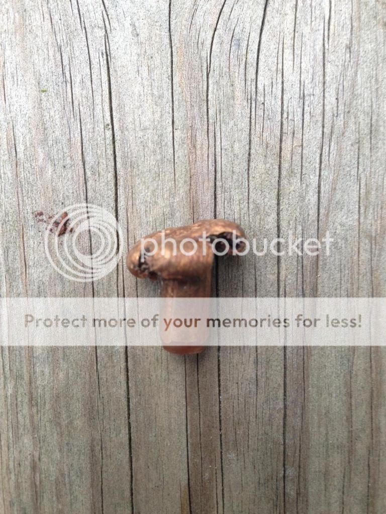

Here's the recovered 140gr Nosler E-tip
I do like my Rem mtn rifle better than the Tikka but obviously it made no difference to the Moose which rifle that bullet came from.
