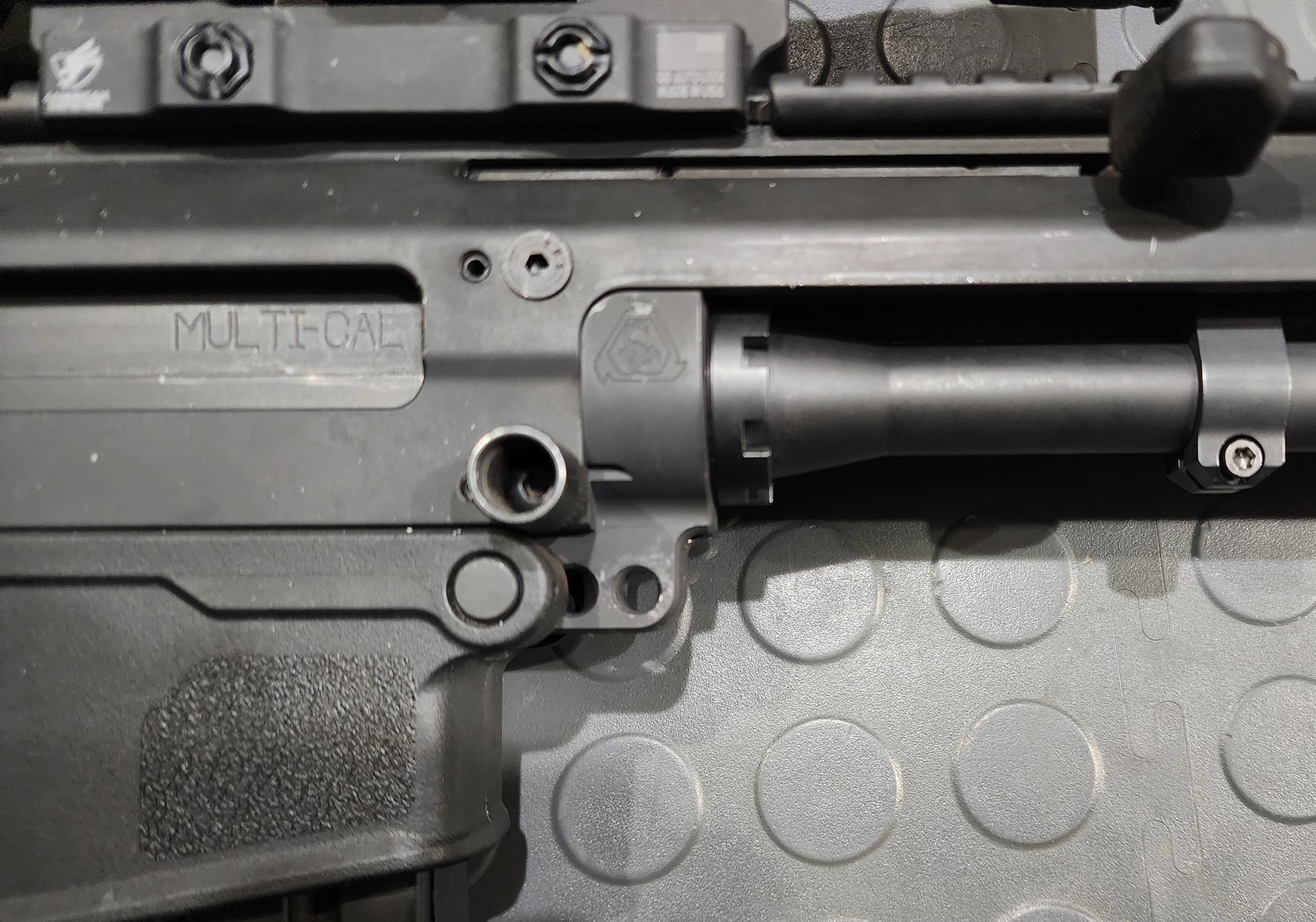

at over 3.5k rounds now and wondering if this is now concerning rather than just cosmetic:
The first pic shows the material has been pushed up by about 2mm. The 2nd pic shows where the charging handle goes to when i release it after pulling it back. The last pic shows where the handle can go to if i manually push it forward with my hand.
The gap between the receiver and the charging handle in the 2nd pic is about 4mm
The gun itself does not experience any issues when running, but sometimes when I want to pull the charging handle back, its completely locked up and would not move. I think this is due to the hook on the charging handle assembly grabing onto the slot infront of the charging handle(hook can be clearly seen in the slot in last pic, under front screw of modbutton). When I experience this, I push the charging handle forward or just wiggle it a bit and I can then pull it back again.
