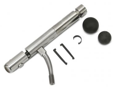

As for when Anschutz began using C clips for the extractors, they have been in use with repeaters in general for a long time. Anschutz started with the first Anschutz sporter rifle repeaters. All 64 action bolts have C clips. All 54 action repeaters have always had C clips (since their introduction in the mid-fifties).
Anschutz Match 54 single shot rifle bolts don't use C clips.
Below are three Anschutz bolts. One is a 64 action bolt, the other a more recently designed one for a 54 repeater. Even the Fortner bolt uses a C clip. The last picture shows a very early 1954 or 1955 vintage 54 sporter, with the C clip on the bolt.

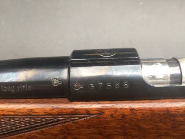

Definitely not a SUHL unless they made a variety of action types. Mine is definitely a clone of the Annie 54 from many years back.
https://www.huntinggearguy.com/rimfire/scorpio-em332a-22lr-review/
Can't find the pics of the action from the 60s 70s. I had thought the safety was a add on to get around import rules but the original Annie does have this very goofy setup.
And a DIP Annie 54 scope base matches up with all the cutouts and contour. Did need fitting cause... like everything else on these clones.
Confident to say this is an annie 54 clone from years back. Trigger group is definitely home brew... but can be made to work very nicely with around 2lbs pull. Unsure if an older annie trigger pack would fit????
And the bolt handle has a thumb 'scallop' so you can hold the bolt back easily with the muzzle up.
This clone checks off all the boxes I would want in a PRS bolt rifle... even the stock.
