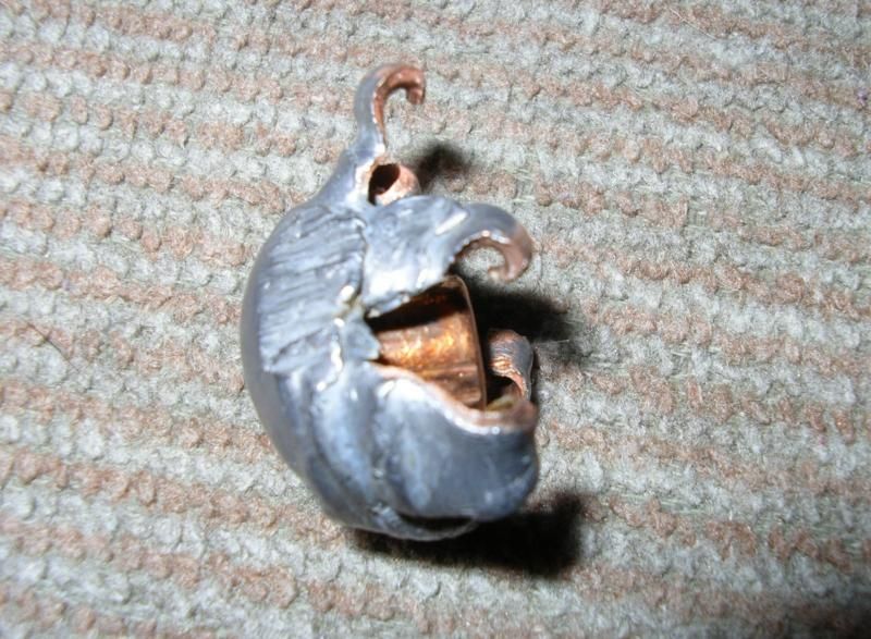

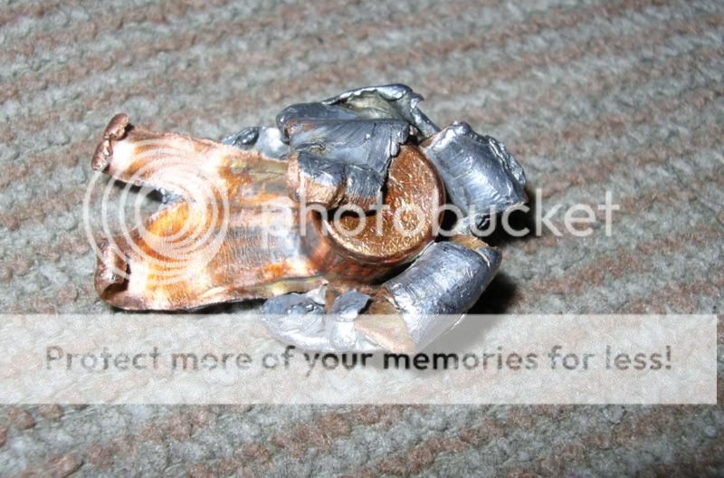

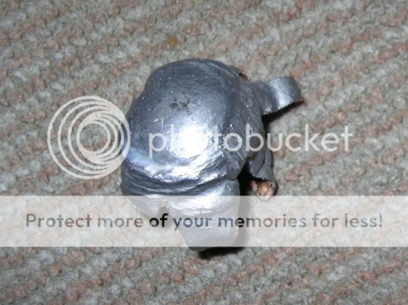

Here you go, Gentlemen. Cutlas65 just sent me pictures of a 290 Matrix he used on a bison yesterday. He asked me to download the pictures.
Here's the text he sent me with the picture. "274 grains of 290 Matrix Ballistics, probably one i got off you last week Ted"
He should be posting here shortly.
My apologies for using so much bandwidth. How can we reduce the size of the bullet pictures?

Yes, and notice how close it is to the ones he used on his first Matrix moose. This is from one of my previous threads.
"Friend of mine just came by with a couple of 290 gr that he used to take a nice bull moose.
Started out at a tad under 2400 fps from his CZ 9.3X62 carbine. He has been sitting here, relating to me how impressed he is with the bullet.
Retained weight is 281 gr after being washed and brushed clean!
So, what is that, 96% retained weight?
The other one hit a heavy bone and kept only around 92%.
Pretty good first experience with Matrix!
So, now Shannon has added bison to his Matrix record. Pretty consistent, even when breaking big bones.
Ted
