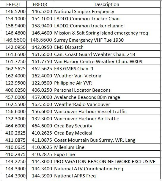

Question for our CGN experts... My radio came pre programmed with about 18 or more channels. No idea what these are. Should I delete them before entering my own channel picks?
I'd take a wild guess that they are FRS/GMRS channels, but if they aren't labelled such, then delete them and start from scratch. With the software, it is pretty easy.
Start with these http://wiki.radioreference.com/index.php/FRS/GMRS_combined_channel_chart
You can add a label to each frequency as you program them so they are easy to understand when using the radios.
... well one of them is a local RCMP freq so best not to use that
Definitely! Although you could choose to simply delete the transmit frequency from the configuration, thereby making it a "listen only" channel. Not much use in my area anymore since they switched to encrypted.
This is the way it should be done with the NOAA/WeatherRadio Canada channels too. https://en.wikipedia.org/wiki/Weatheradio_Canada
(very handy to have those on your radios)
