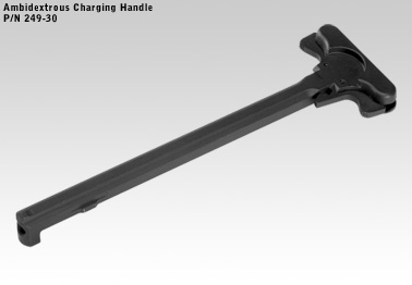

The cocking handle will break on a regular basis....the longer "lever" and original tiny axis pin (roll pin) results in a broken axis pin on a distressingly regular basis.
Out of 20 weapons, we've replaced 4 so far.

New cocking handle
snip!
....... okay, that's just... seriously? o_O I thought the design would've been a bit slimmer.
<-- thought that was the new C7 ambidex charging handle

The new cocking handle is SUPPOSED to be designed to allow for a one handed grasp by either shooter, which is why one portion sticks out beyond the sling swivel. The problem with this handle is that the roll pins break. But there is no reason not to #### the weapon with one hand. I have done it, I have taught it, and I have been shown this by some "special high speed" soldiers (of which I am not one).

IMHO... the new A2 is too front heavy. It's bad enough that they put a full length barrel on a carbine butt, but the tri-rail just adds insult to injury. Too cheap to buy shorter barrels and a RIS to replace the handguards? Same thing for the 4-position butt. If you look at the thing, all of the adjustment holes are at the rear... too cheap to drill two more holes? Same thing for the pin that holds the cocking lever in place... so many of those things broke. Too cheap to use a proper pin?
