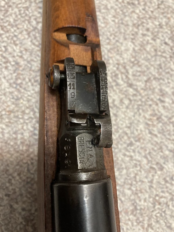

Rear sight was also pretty bent up, had to disassemble it all and streighten all the parts in a vise, otherwise the long range sight was obscuring the battle sight view when flipped forward - at least that's sorted out now.
What's the trick to disassemble the rear sight? My "push to adjust" bar for changing ranges is pretty bent up and very difficult to push in (as it turns out, it was on 'battle sight' setting on arrival and was just looking again at the rifle last night and noticed). I'm hoping to maybe be able to disassemble and then straighten the thing so it operates smoother
You can unscrew the sight from the barrel (2 screws), and you can detach the flat spring from the sight blade and remove it.
The disassemble the push button, you need to support the button with its shaft in a slot and punch out the riveted on shaft. Not easy to do. After cleaning, you re-rivet the shaft.
It is likely not worth disassembling the button assembly. Clean it up best you can with a fine steel wire wheel in a Dremel and oil the crap out of the shaft if you don't have the necessary skills.

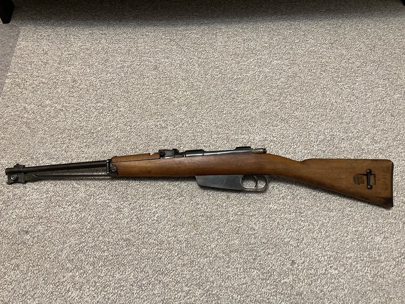

1936 Brescia. Wood matches receiver and overall is in Fine condition. Very slight surface rust in a couple places, bore looks good. No cleaning rod.
Overall, very very happy with this rifle! Thanks GNG

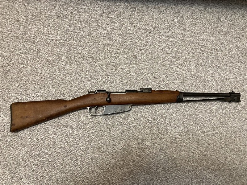

Mine also arrived today, Also in good shape, No cleaning rod, I think I may have thrown out 2 Carcano cleaning rods when I was cleaning my loading room as I didn't recognize them, So that's unfortunate, Anyways here it is.
