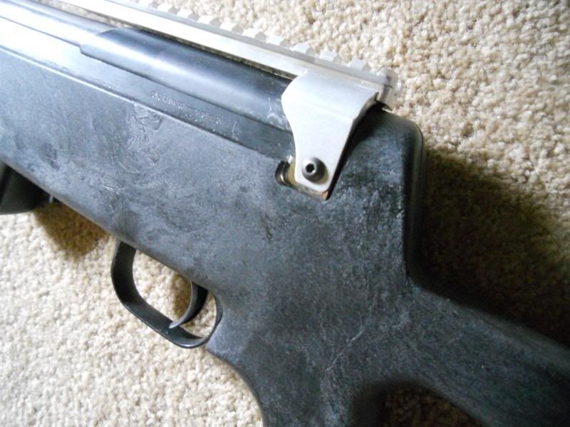

You may need to modify the plastic ATI stock to accept the rail. Many aftermarket stocks ride higher on the SKS action than the standard wood stock.
This is a close up of an old ATI Dragonov stock, showing the milled out plastic area necessary to accomodate the rail. Measurement is 7mm by 19mm ....
