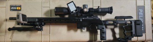

My B14R likes Eley Club, SK Standard Plus and Long Range, but thank the heavens it groups CCI SV at 90% of the performance of the first three spendy flavours.
People will balk when I say Remington Thunderbolts shoot well in my Glock 44.
Have a wack load of high end stuff to try in my Ultimatum Deuce when it shows up.
