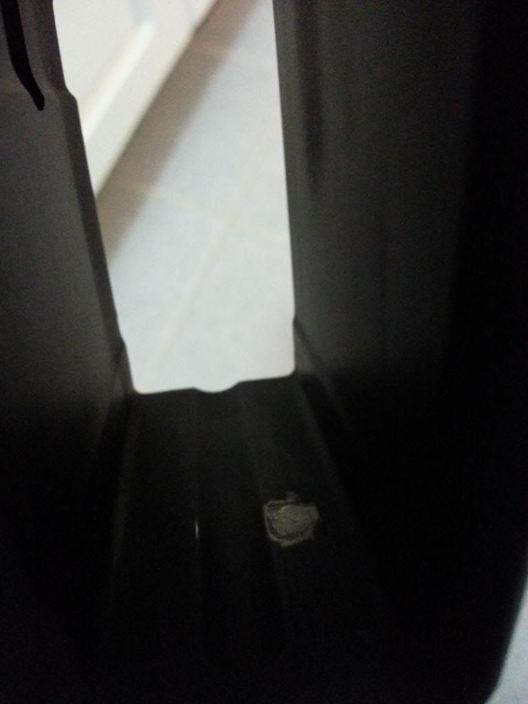

but does anyone have white spots on their lower? theres one in my magazine well. ive tried to wash it off but it wont come off.

The white spots are bare aluminum. That is where the receiver was hung or supported from when it was anodized. If yours is like mine it will also have a bare spot on the back of it where the stock holds in place. This is not typical of other receivers I have.
