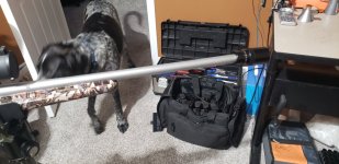

I have a Harrell Tuner - clamp on style, yes they are made, but not easy to find now and at times ... they are great for rimfire and air guns ... this one is for a Heavy Barrel and made for .915 diameter heavy barrels.
They have very accurate small audible- click adjustment, and easy to use .... you mount it with the Tuner adjusted to 0 ... Allen key tightening.
When you shoot groups, just move it increments counter-clockwise at a time > follow the numerals; until you find your tighest group - with your air gun setting or rimfire ammo.
It will fit a .915 heavy barrel perfect! That's what this one was made for. It tightens up snugs up Allen screws ...
PM me if you want it - I have no longer use for it - I do not have a current .915 barreled rifle. It's in minty excellent condition. You can Google further instructions on how to use. But it's easy.
I do still use a screw-on Cortina Tuner on my Bergara BMR .22 - they are great tuners but upwards of 400.00 or so/with adapter. Dominion Outdoors used to sell them, but no longer due to the recent USA importing BS.
Also Freedom Adventures is another Tuner store ...
