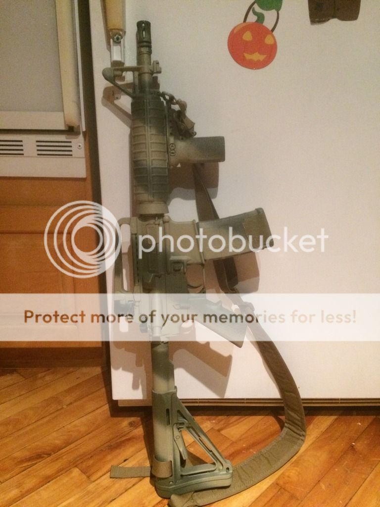

Here is my retro build with its retro paintjob.
Paintjob I used Krylon Camo OD and Khaki and sealed it with Krykon flat clear. I taped the serial number, rear sight, front sight post and jammed an earplug in the muzzle. Did 3 coats of OD after a light clean up (10mins between coating) then did the khaki stripes and touch ups.
No net, no burlap, I wanted a simple look to remain undetected by Figure 11 and other paper ennemies :p
"The Build": its a part bin build
-Dominion Arms upper/lower
-CNA 10.5" barrel 1:7
-Magpul MOE Stock
-Magpul RVG mounted on a cadex rail
-Colt Canada handguards
-TNA FSB, gas tube, D-ring, barrel nut and handguard retainer
-BCM Charging Handle Mod4 medium
-Ferro Concept sling
Do you guys finish with a lawyer spray?
Excuse my frogness, what is a lawyer spray ?
I do finish all my paintjobs with with krylon flat clear (2-3 coats). It does protect the finish a lot, I did a water bottle that has been thrown around a lot since 2015 and it is still 95% covered with the original paint.

Simple, I'm a fan
