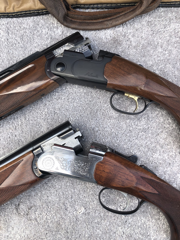

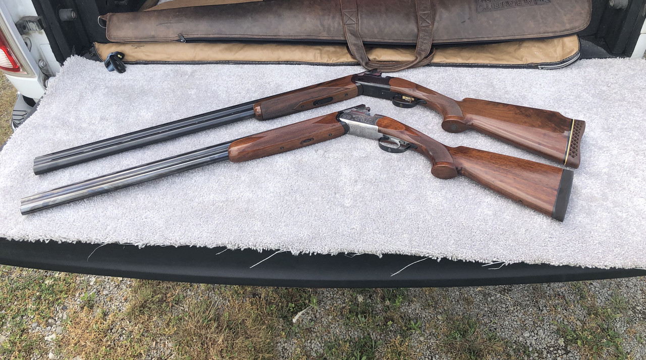

Let's see some pic's of your SxS's & O/U's
