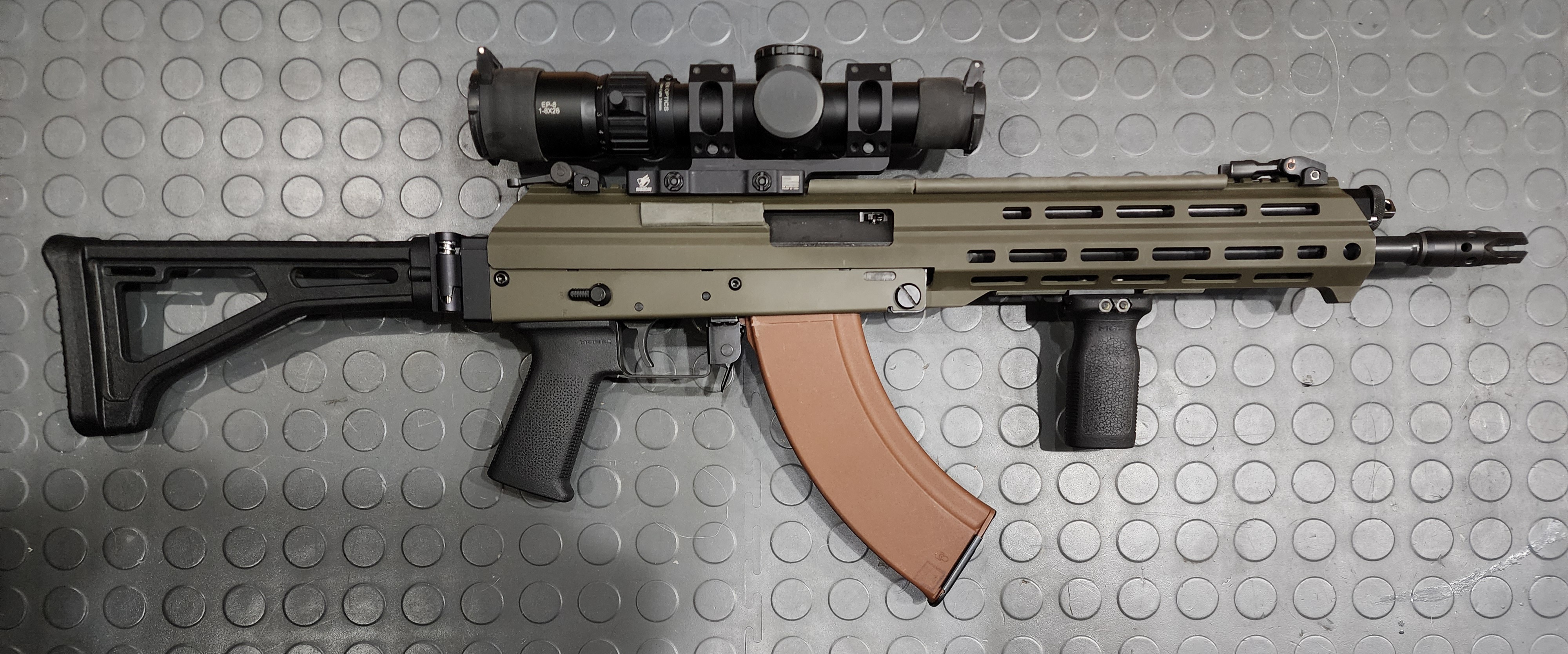

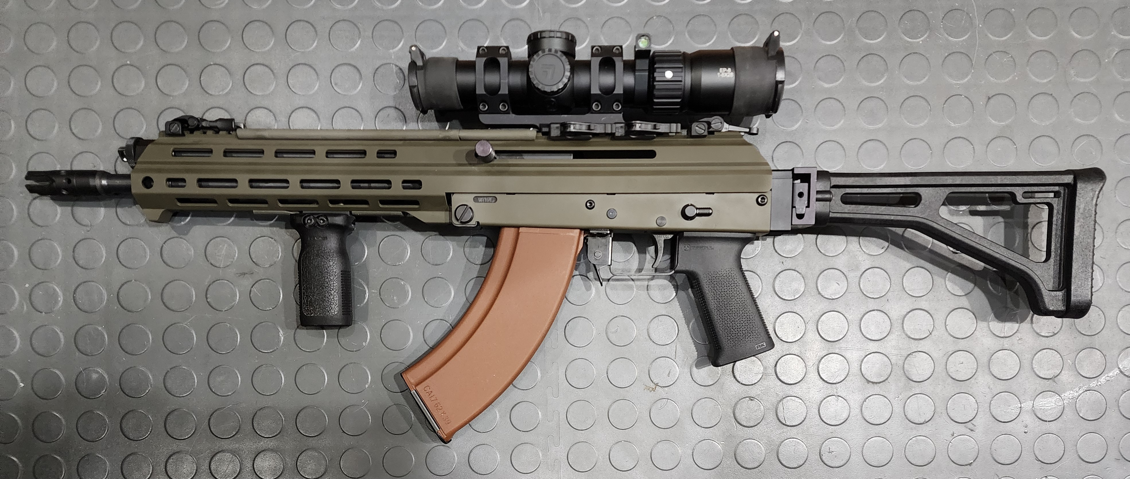

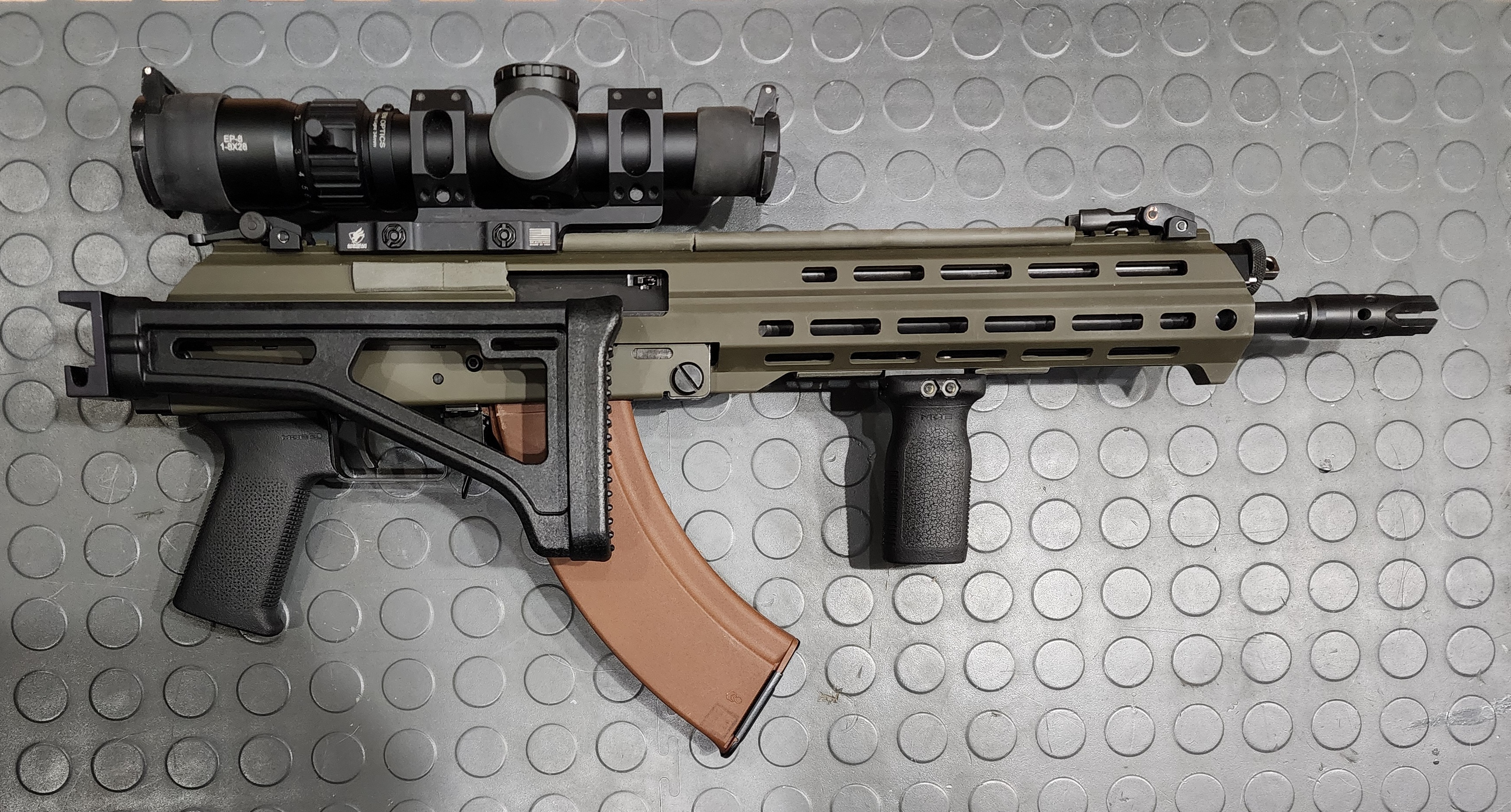

Well, I took the plunge and had the CSC 'Smith spool me up a 12" Barrel on a CeraKoted ODG Receiver with a Lage (Fixed) Buttstock. Basically I wanted a modernized "Krink" based on an "improved" AK long-stroke action in the M+M M10X. The M10X is actually far more SIG 550 than it is AK, but whatever - externally it has visual AK cues based on the Magazine and Receiver Shape.
I happen to have 3 Lage Manufacturing Buttstocks on hand at home, all equipped with variations of the Lage Folding Mechanism. So I was able to "rob" a Lage Universal Folding Adapter from one of my PCCs to go between my new "fixed" Buttstock and the M10X's Lower Receiver. Works perfectly, as you would expect. I have replacment Lage Manufacturing items as well as a new Cheek Riser enroute via mule-train from A Z T E C H Armoury. Those parts will arrive some time in December, but at least the A z t e c h s have been reliable to date!
You can really tell the difference with the M10X's new milled receiver. The the M10X has easily the smoothest "AK"/SIG 550 style of action that I have ever felt. Even nicer than my Galils or Valmet M76. Definitely nicer than my Russian AKMS. This 3rd Generation of the rifle is extremely solid, with zero rattle or play between the various parts. It would seem that among other things, M+M has addressed the slop/loose tolerances that used to exist between the (formerly cast) steel Receiver and the outer aluminum Handguard. Things are nice and tight when you slide the parts together or apart during Field Stripping. The AK-style Trigger is quite good, with a bit of take-up followed by a solid "wall" then a fairly clean break. The Hammer now strikes the Firing Pin with extra strength thanks to the new coiled spring that M+M has finally adopted.
I am very much looking forwards to first rounds downrange, likely tomorrow!
