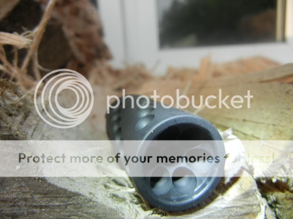

Check out this vid on Youtube. It's a demonstartion of the Ferfrans CRD with and without the blast shield installed...similar to the GA blast shield, but the Ferfrans shield is perforated. At 7:45 of the vid, the demo starts. You be the judge...I think there is a subtle difference, as expected. I also think that there may be an even greater difference with the GA shield, because it is a solid body as opposed to a perforated one.
Good eyes! I didn't catch those tiny porting on the Ferfrans CRD. I thought they were just dimples.
