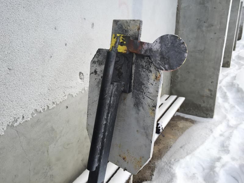

Poppers are AR500 from the same guy, and I just welded a grade 8 1/2 bolt onto it. For the tube that it fits into I used 1/2 pipe. Any pipe nipple will do. Trick is to have it angled down a little so when it swings and stops its stays where it should.
I managed to get out this weekend and do some shooting. The 10" one stood strong no problem. The mini ipsc torso does not have enough weight and went flying bringing down the saw horse. It did hold up really well at 24 yards with the .22. Might keep the mini for .22 and the 10" for the long bombers.

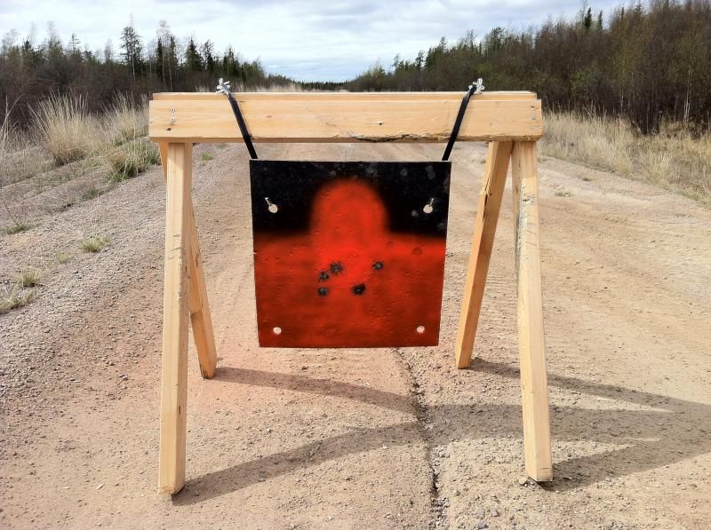

I picked up a sawhorse yesterday and put things all together when I got home.
Total cost was $30 for sawhorse, chain, quick-links (with a couple of spares), carriage bolts, washers and nuts. Bought it all at Canadian Tire
I already had a 10" gong from my Caldwell setup. I have to figure out how to hang my 6" gong now. It's currently set up with a single length of chain welded to the top to hang it from a support.
