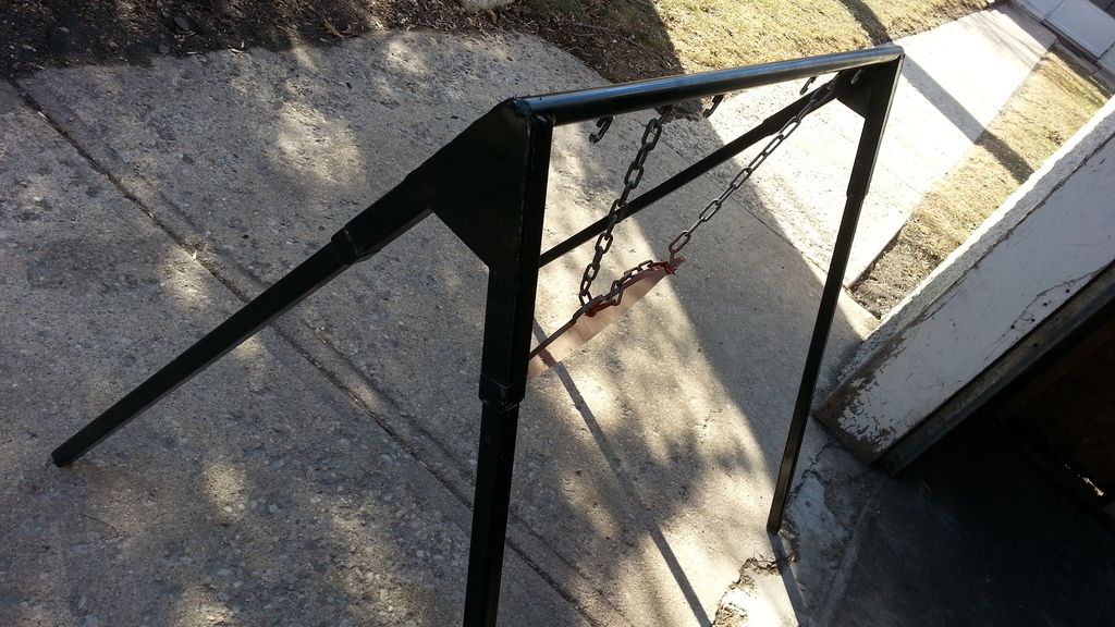

I just got one built out of square tubing with removable legs, ill get some pics up here soon. I took a few shots at the 12 in gong with a 270win and the plate hardly swung at all.

the legs are removable,
the smaller square tubing fits inside the larger one. if you lift it up the legs will fall out.
im thinking about drilling a hole through the leg and top piece so I can put a pin through. not sure if its worth it tho. once I set it up I don't move it until im finished
Looks pretty robust can you fold the legs down?
Voila
Bought the adjustable one today. Heres what I have so far. Need to drill some holes in the legs for some pegs and should be golden.
