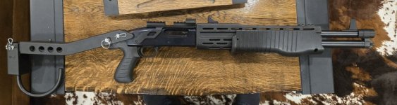

My Maverick 88 with Spas12 body kit

This is the second attempt to print the folding stock. Was a 20hr print. First one failed somewhere in the 85% area, the piece fell off my printer😔. This second attempt I wasn't home for when it finished, and looks like she got a little too hot and kinda melted the tip. I'm going to see if I can salvage it by sanding it down and using some jbweld or even the same nylon filiment to build it back up. That being said, the part "should" be usable.View attachment 830275View attachment 830276View attachment 830277

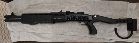

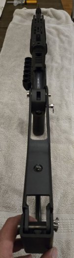

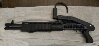

After a ton of work in the shop, I made the folding stock from 2" square tube 3/16" thick. Feels way safer and durable then the 3d printed one. Definitely a heavy beast though. Maybe a 3d printed one would hold up, but I didn't really want to find out. I thought about 1/8" but I wasn't sure about the flexing of the arms being that it's just mild steel and no spring steel or hardened.
No bead rolling on the stock like the original. I don't have that capability. I thought about making a faux bead with some half round plastic and adding it, but I feel this looks pretty clean as is.
I used these stainless steel indexing pins for the folding butt and stock. I think they are pretty slick.
The original spas12 uses the front sight to lock the folding stock or the grip assembly depending which version. With the construction of the heatshield and grip, and the way they are secured, there's no way I could have done this and had it been durable. Using the grip was my other option. But, I printed a new grip assembly in 1 piece, hoping that would be even more strong and less hardware, but removing the capability of this type of securement. I tried to find or design some sort of double ended pogo pin that was retractable to no avail. I ended up using a indexing pin to release the stock, and a picatinny sling attachment to secure it folded. Seems to work great with some mods. I had to install and modify a picatinny accessory and it sits a little higher then normal.
I still have some minor fitment and securing to do, but this should actually be shootable now.
I still need to remake the action slide arms out of steel, and possibly the action slide itself, to give me 1000% confidence.
The grip is 1 piece printed nylon, 20% infill. Around the bosses and mating face to the reciever I increased the perimeters to hopefully translate into strength.
The hook is 1/2" steel bar, that installs and swivels identical to the original. I bent it with a press, vice and box wrench to get what I think it something close enough to mirror the original. No "F" on the bottom though. I tried printing one, but just wouldn't come out fine enough for me.
The sight is still visible with the picatinny rail and sling attachment, but I may down the road add a cantilever picatinny rail to the aft end so that a red dot sight could be added to sit aft of the rail as not to impose on the folding stock when it's moving. Anything wide and long would make contact when the stock is being folded.

Beautiful work, the spas12 is one of the large list of guns banned before I was born that I wish I could get, if you do sell kits put me down for one
Thanks. I'm not sure if I could actually sell much of a kit. The only thing 3d printed now at this point is the forgrip, heatshield, and grip.
The folding stock, butt, and action slide is all steel.

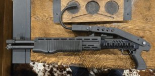

I finished making the action slide and arms today. The arms are 12g stainless steel. The rest is mild steel. I wasn't sure what the original arms were, so I went this route. I'm sure they'll hold up for a long time. Used a small roll pin to keep them in place, hopefully it will be fine, I know roll pins are pretty strong. I'll have to weigh the gun when it's back and all assembled, she's definitely gained a few pounds lol.
I'm a bit nervous for the recoil. The stock butt has padding and I still had a sore shoulder. This being all steel is making me question things lol. Im hoping the added mass will absorb the recoil, vs thowing that mass into the shoulder. I'll find out the answer to that after the first shot lol.

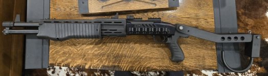

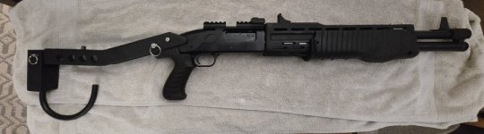

In hind sight I think doing this mod to a semi would have been way easier than a pump. Wouldn't have to worry about the action slide and arms. Everything's fixed in place vs sliding and moving. I've heard multiple times that the spas is a terrible shotgun. Mine I don't think will be any lighter though.
Well, she's all assembled! Well, missing the small sling attachment at the grip. But everything else is done! Seems to cycle fine and smooth.
She weight 12lbs according to my scale. She's heavy lol. Factory version of my 88 is 6.5lbs according to the website.
I'm hoping my next post will be a video and how she preforms.
If I ever get welding capability for aluminum, that would be nice to bring the weight down, but it will be a range toy that sits in a safe, so long as it works I'll be happy for now lol. Wife is already telling me I spent too much time for a gun I shoot once a year lol.
