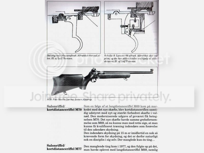

M69 (produced 1969-1979)
Carefully inspected K98, Gew 98, or M98 (Radom, Vz-24, FN) action, bolt, and bottom metal sourced from abandoned German Mausers.
**ANY year or factory combination is possible.
Usually non-matching parts, but occasionally matching, or, force-matched.
S&L-made target stock made of strong European Beechwood
**K98 style stock recess and lower profile shaped bolt handle sometimes found on later M69 builds.
Polished/re-worked K98 or M98 trigger, OR, S&L-made adjustable trigger
**S&L-made adjustable triggers typically found on later M69 builds
S&L-made rear aperature/diopter sight
S&L-made front globe (tunnel) sight, press-fitted
S&L-made medium heavy contour target barrel
Waffenampts and other military stamps sometimes left intact, but much less so on later M69 builds.
So, for a target rifle, an M69 is the way to go. However, whether or not an S&L adjustable trigger is included shouldn’t be a deal breaker as a Timney trigger is only $100 and is superior. Lastly, don’t let “minor surface rust” or “blue wear” deter you. This is easily remedied by way of oil/0000 steel wool or a complete refinishing. Bare metal can be easily polished to “in the white” again, and wood stocks easily refinished. There’s a beautiful, well-made rifle under that “thin layer of age”!
