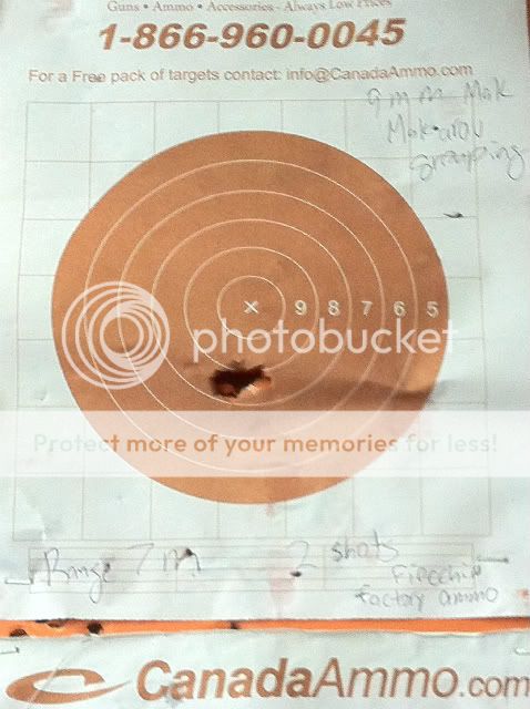

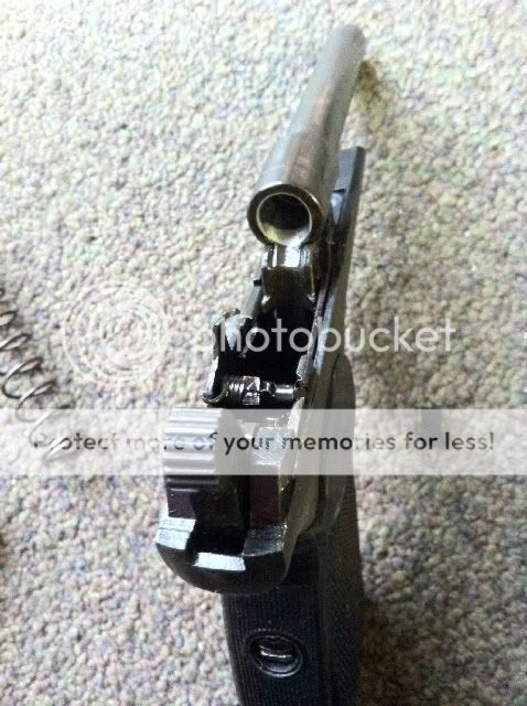

I was using Fiocchi factory ammunition. No the gun didn't blow up but failed to fire on the 3rd shot. I am uploading the pics at the moment. I'll post the grouping as well. (I got my temp att to the post office within 15mins) XD
Looks like the slide stop failed...? Odd. Almost as though one of the rounds was over-powered.
Glad you are OK.
FWIW, it looks like a new slide stop might repair it.
