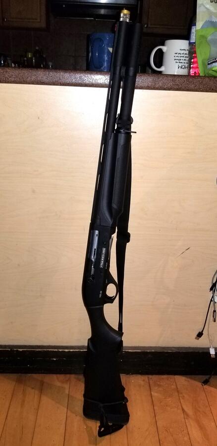

Got my VR-66, already got a Tacord trigger spring in there (thanks Casey) and it dropped pull from 6.5 to 4lbs.
Will try to run some different loads through it hopefully before the weekend.
