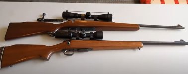

WELL ! Things Change 🤪 I now own a Rem M788 222 24 “ barrel . Bluing is pretty good - Stock needs refinishing but is Easy Peasy on this model with no checkering . I’m gonna get the barrel shortened to 18.5 “ Soon . The stock will get refinished in about March .The sights have being removed which I would have done anyhow 🤷‍♂️ I’m looking to purchase a spare mag for it too if you know off one for a REASONABLE price . Any one good at dating a M788 ser# 6173152 X X on the barrel ! Thxs RJ

I wouldn’t chop your barrel down to 18.5”. Unless there’s some issue at the muzzle. If it’s a 14 twist you’ll have trouble with stability and chase your tail. The easiest to tune in my experience is 24-26”

Peecos - I’ve owned 2 M600 Rems and they were both 18.5 “ 14 twist barrels and both shot Very Well with 40-55 gr bullets . 👍
