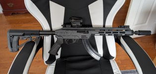

I just picked one of these RF's up and after tearing it down and lubing it up, pretty sure I hate it already lol. Just the build quality is abysmal, the softest aluminum and polymer imaginable, the paint finish was done in a kindergarten class I assume.
I'm familiar with 10/22's so I know where problems come from, made sure to to clean and lube the problem areas.
The plastic sights are going right in the trash lol.
I got it looking cool, if it impresses me shooting it, I may change my mind, but it looks like junk out of the box.
It does cycle dummy rounds fine with every mag I've tried so far, so that's promising.
