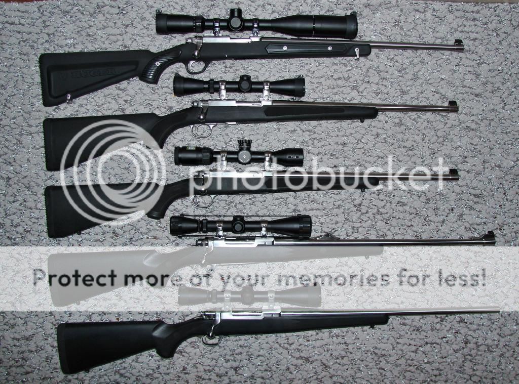

Nice collection, the No 1's as well. How on earth do you manage to pick which rifle to use? Range in you backyard?
I had my own 500 meter range for 25 years... the farm sold last year... I am now a regular club member... as for which gun to choose... it is much easier now that I have downsized from 130+ to low double digits.
