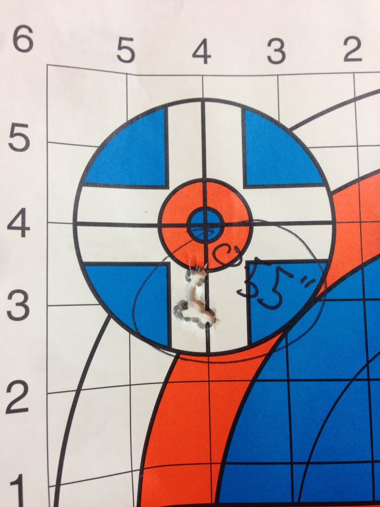

Finally got mine out today. First time shooting my reloads too. The results couldn't have been better. Best group was 0.550". Looks like I got a good one.
41gr of IMR 4895 pushing a 168gr berger.
