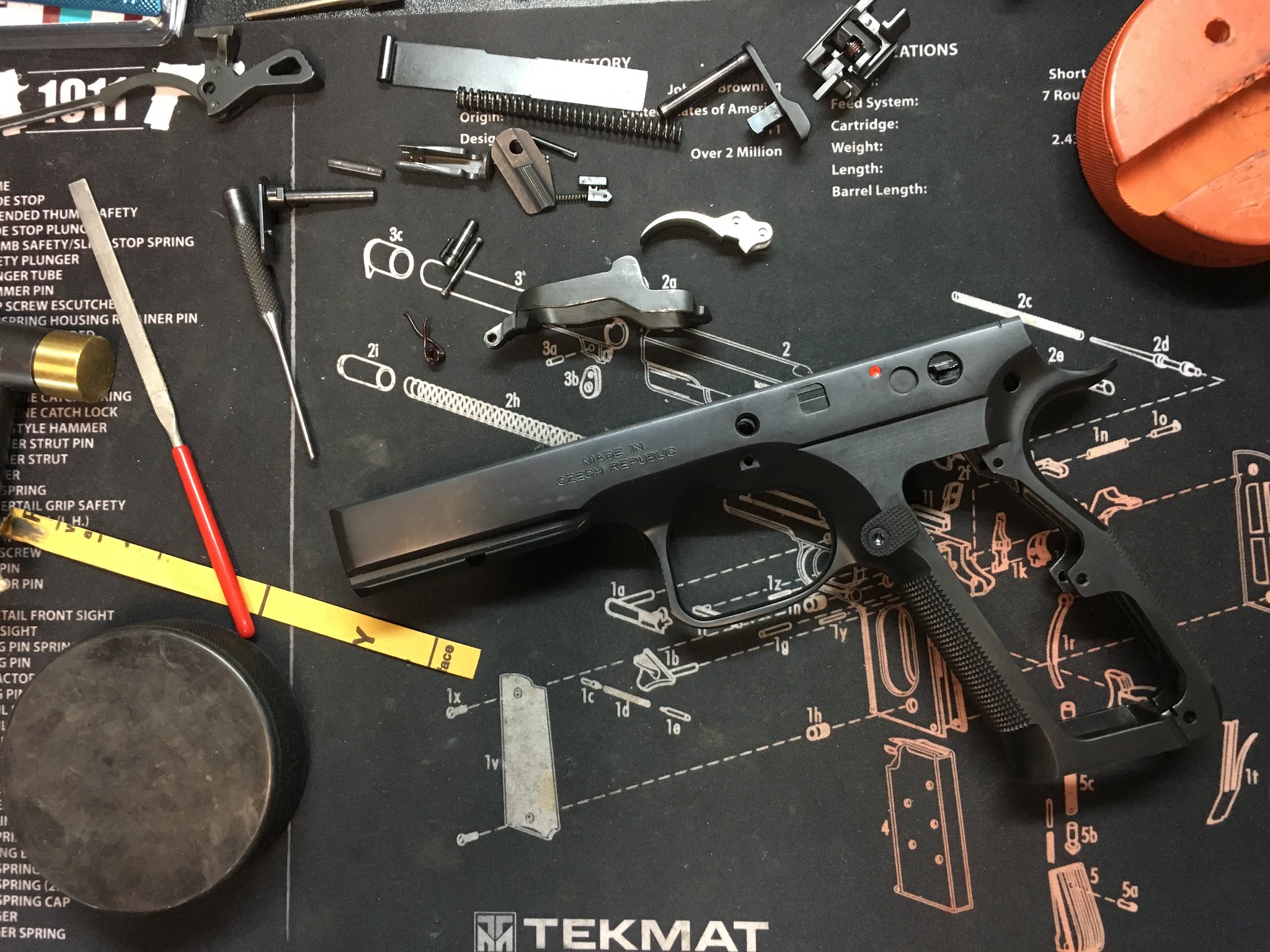

This would be my Shadow 2. Full strip minus mag release and extractor on the slide for polishing up contact points and changing out hammer, trigger and sear springs. Always a nervous thing the first time with a new gun but I've done it a few times already so it's pretty quick to reassemble.

Any tips on knocking out the pins that secure the mainspring strut and disconnector onto the hammer? I've been banging away to no avail.
Those pins are staked. You'll need a taper punch, heavier hammer and a good support like a block, hockey puck etc. I didn't think it was worth disassembling that part. I did remove the rough sides of the strut and polished it smooth.
I've got everything except a bigger hammer and a taper punch. However, I don't see a big difference between a pin punch vs a taper punch. But I'll order one just in case.
because the pins are staked so heavily, a regular pin punch will often bend during the course of hammering them out. A starter punch has more meat to it and won't bend and will allow you to break the pins free and use your pin punch to get them the rest of the way out.
If you don't have a bench block with the hammer cut out (CZ Custom sells them and they are awesome) simply use a scrap piece of wood and drive the pins into the wood by laying the hammer level on the wood. easy peasy. If you are swapping to a new hammer, once the pins are part way out, line the new hammer up and tap it onto the pins, then drive them further in, releasing the strut and disco, place in new hammer after polishing and continue to hammer the pins through. I do not restake them. It's not needed in my opinion. Staking is to prevent them from falling out during disassembly and is a carry over from the old military requirements.
