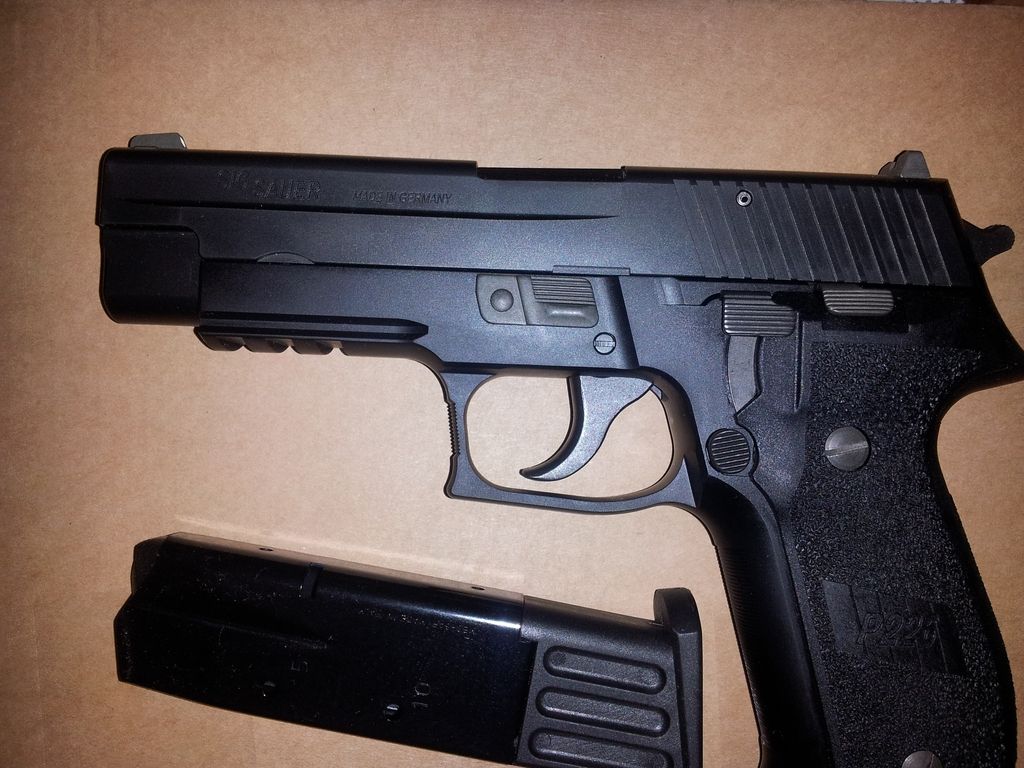

My first of what i hope will be many Sigs. Old picture after her first workout.

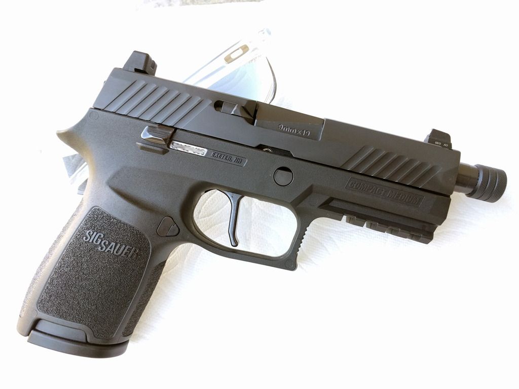

Finally got my P320 Carry! Love it.
Initially concerned with the dreaded P320 "Double Click", I was able to rectify the "problem" with my my poor-mans milling machine (i.e. drill press + blue/green dremel grinding stone); I removed .010" from the Trigger Connector and got the firing-pin release-point and sear-disconnect where they should be (i.e. within 1mm pull of each other.)
Love the ergonomics and trigger pull... solid polymer pistol. My new favourite.
Here she is with both trigger and frame swapped. Cheers~!
That would be great, my friend picked up a p320 and it does have the double click issue upon dry firing, I suggested he return it but the place he bought it from said it was 100% normal...The double-click feels crappy and not right (lots of videos online.)
Apparently really bad double-click (like mine was) and the shooter can create a dead-trigger after firing; the fix is simple though and awesome. I'll post pics later to show.
