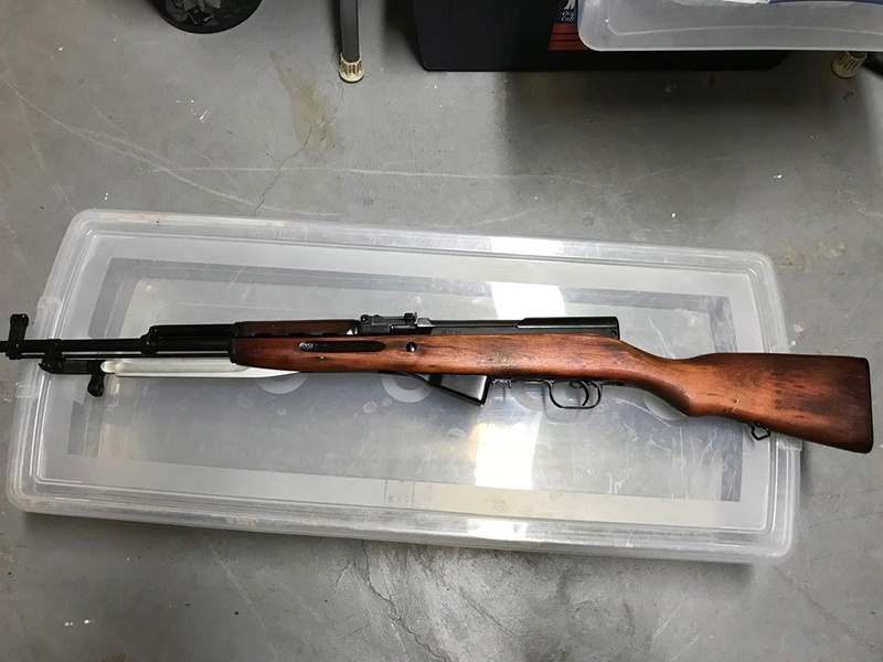

recieved a tula 54, bbq, missmatch, stock sanded. Can it be worse than that ? lol

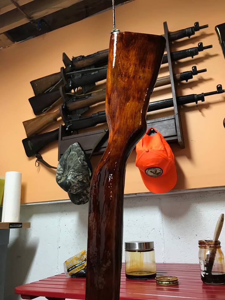

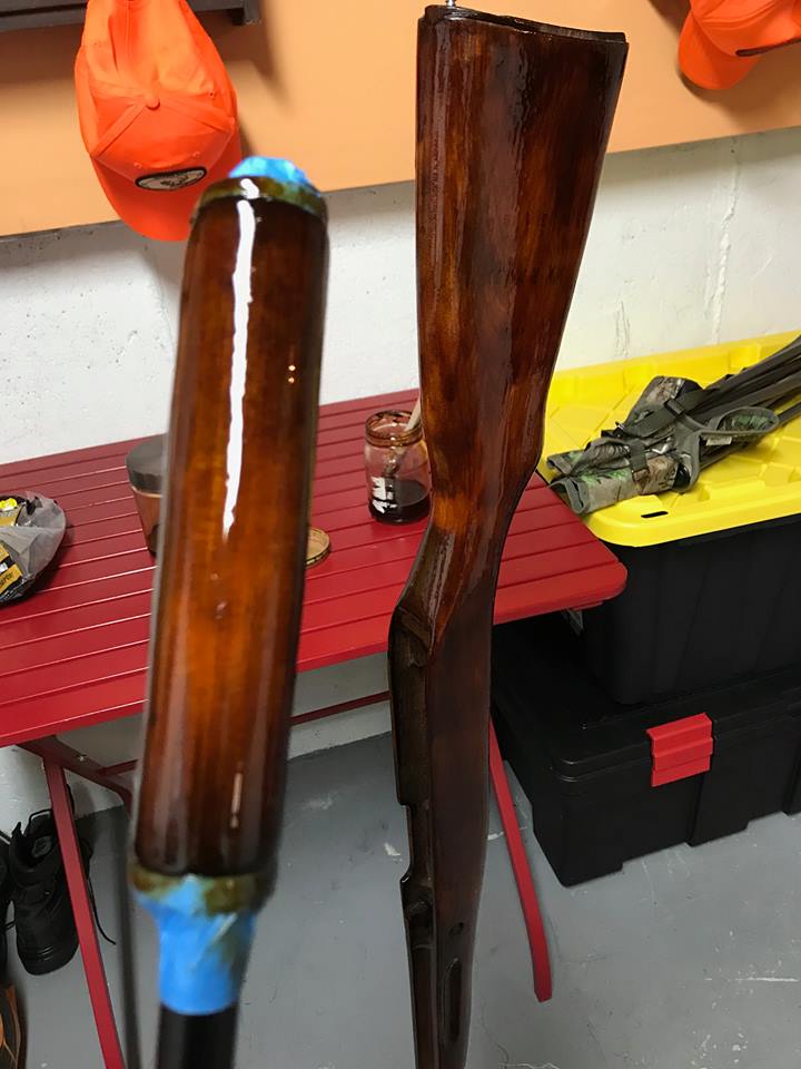

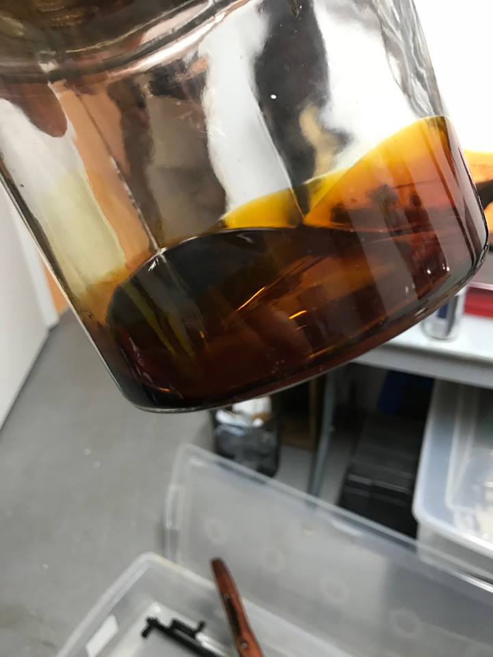

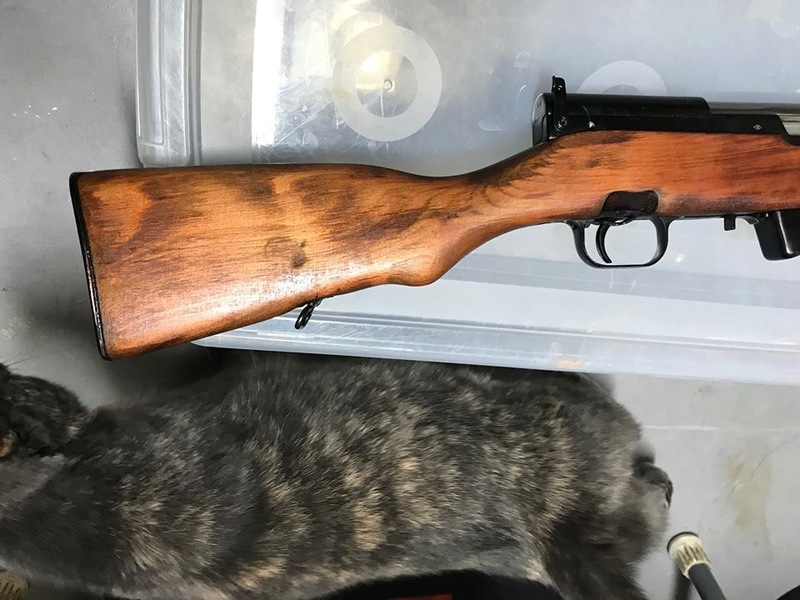

I could have contacted them and ask for a return and refund but huh, I have a left over cherry shellac I made 2 years ago that it turned very thick and dark. Its gonna be a refninish project..
Actually, I just applied the last coat this morning.
You just have to love that Red colour. nice job . if you can post the mix ratio to come up with that. good job.

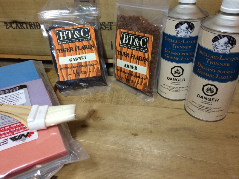

Shellac ''garnet'' flake and the shellac thinner bought at Lee Valley
and to accelerate the coloring I add a bottle of Iodine tincture
I refinish another stock 2 years ago and I needed around 15 coats to get the same result at that time. the left over from that time became very dark and thick and after only 3 coat I have the same result
