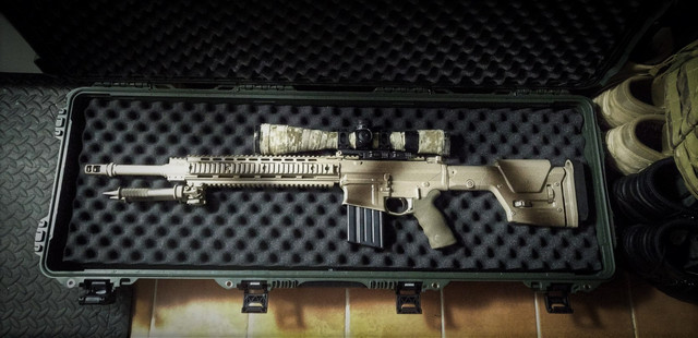

My M110 ish build.
Stag receiver. IBI Heavy DMR match barrel.
