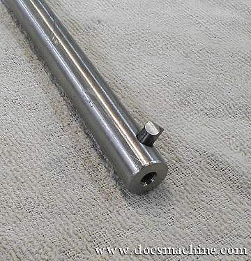

Found this on a barrel search on a paintball website. Homemade rifling tool.
The cutting bit is held in place loosely by an indexing pin through the front and is pressed upwards by spring pressure. Would prolly work well for Aluminum...hmmm
