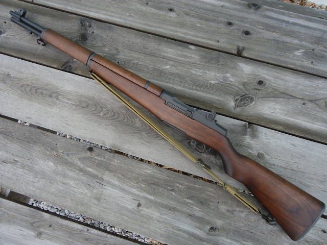

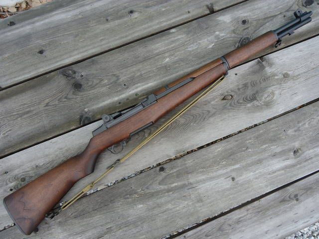

Well here she is. Nick at Vulcan did a hell of a job!!
All PB parts except the barrel which is a VAR and the Boyd's Stock. Sling is FKF marked to match the receiver.
Oh my ^.
All PB and a VAR tube.
Can't imagine how much searching around it took to pull that one off MBaker!.
Congratulations. Such a fine rifle you've built from the ground up.
Noticed that the front sight base looks somewhat different from mine, what you got there?.

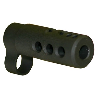

thinking about throwing this on my m1 garand. since mine is chambered in .308 do i need to worry about over pressure on the oprod with the muzzle brake installed? ( i shoot mostly norinco 308 out of it but i will be starting to do my own reloads in the new year.
