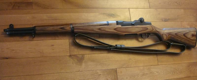

Just finished puttting the new SA 1955 barrel on the new Breda receiver and added the Dupage laminated stock ....I love this rifle !!
