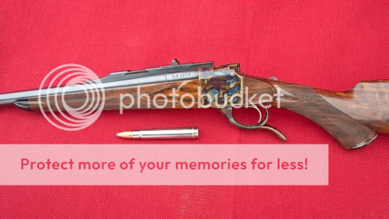

Out of curiosity, would the Hagn Mini action accomodate the 6mm Rem cartridge... or would that require the small action?
Scooped this from the website... the caption stated; "Mini Action in 6.5 Grendel," but while the barrel stamp would confirm this, the cartridge shown is a .375 H&H.
If, in fact, they can do the Grendel in a Mini action, having it necked down to 6mm would result in a dandy little cartridge.
Pretty rifle. One of these in 6mm. BR Norma would sure be fun.:)
It won't accept a 6BR, the PPC / 7.62x39 / Grendel case head is maximum for the mini. And yes, very different world from TC.
As much as I dislike the typical platforms, I love the X39 case... necking one down to 6mm or quarter bore would really get me excited... great "doe-culling" cartridge... of course there are lots of great light-medium gane cartridges, but a 6X39 or .25X39 would sure be a cool one... the Grendel is cool in it's own right.
