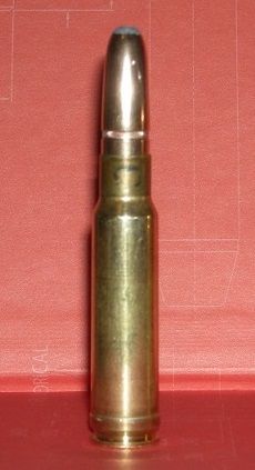

According to the Powley computer your increase in COAL should = about 100 fps with 250gr bullets. So you are likely above SAAMI pressures.

My custom .350 Remington Magnum built on a Remington 798 long action with a 24" 1-in-12" twist McGowen Precision barrel. No issues with heavy bullets taking up case capacity. Near maximum load performance using Reloder17: 310gr bullets at 2500 fps and 250gr bullets at 2700 fps. Fine accuracy.
Remington 798 .350 Rem. Mag. with Bushnell Legend Ultra HD 1.75-5x32mm scope
