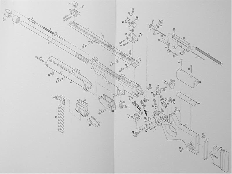

Heckler & Koch SL8-5 parts list.................RED = direct replacement with G36
....................................................................BLUE = can be used on G36
Item.......description..............................Ident No.
X...........SL8-5 .223 cal...........................207 737
1...........reciever....................................218 443
X...........barrel, complete (2-5).................217 906 on G36 0nly as a complete set
2...........barrel.......................................217 907
3...........nut..........................................205 378
4...........gas tap-off................................217 919
5...........clamping sleeve..........................927 605
6...........piston complete..........................205 381
7...........rod, complete.............................205 384
8...........sight rail, long............................217 947
9...........sight rail screw x3.......................986 785
10..........sight rail washer x3.....................214 112
11..........sight rail threaded washer x3........214 113
X...........front sight, complete (12-14)........217 933
12..........front sight.................................217 796
13..........ront sight holder.........................217 795
14..........clamping sleeve..........................928 747
15..........sight screw x4...........................988 428
X...........rear sight, complete (16-24).........217 925
16..........clamping sleeve..........................987 695
17..........rear sight housing.......................217 991
18..........compression spring .....................217 504
19..........rear sight support.......................217 992
20..........rear sight..................................217 997
21..........compression spring.....................217 518
22..........leaf spring.................................217 515
23..........elevation screw..........................217 505
24..........windage screw............................217 517
X...........bolt assembly (25-42)..................217 908
X...........bolt head, complete (25-32).........205 404
25..........bolt head..................................205 405
26..........extractor cylindrical pin...............214 644
27..........extractor ..................................205 406
28..........extractor compression spring........205 407
29..........extractor rubber bolt...................214 662
30..........clamping sleeve.........................928 389
31..........ejector bolt...............................205 408
32..........compression spring .....................205 411
X...........bolt head carrier (33-38)..............217 909
33..........compression spring.....................205 393
34..........fork.........................................205 394
35..........bushing....................................205 473
36..........cocking lever............................205 395
37..........rivet........................................205 210
38..........bolt head carrier........................217 910
39..........control bolt...............................205 390
X...........bolt, complete (40-41)................205 412
40..........O-ring......................................983 411
41..........bolt.........................................205 413
42..........firing pin...................................205 391
43..........recoil spring,complete.................205 445
X...........buttstock,complete....................217 914
44..........cheek rest screw x2...................988 372
45..........cheek rest................................217 948
46..........cheek rest spacer......................217 916
47..........buttstock.................................218 449
48..........buttstock spacer.......................218 448
49..........butt plate, complete...................218 450
50..........buttstock screw x4....................217 903
51..........backplate.................................218 447
52..........buffer......................................205 452
53..........hammer elbow spring..................205 428
54..........hammer....................................217 936
55..........hammer elbow spring..................205 429
56..........catch disk................................217 614
57..........catch piece..............................205 419
58..........compression spring.....................205 418
59..........sear........................................205 439
60..........sear compression spring..............217 917
61..........trigger elbow spring....................217 918
62..........trigger.....................................217 934
63..........bolt catch elbow spring...............205 466
64..........bolt catch................................214 879
X...........locking lever, complete (65-68).....219 094
65..........elbow spring.............................214 616
66..........catch......................................219 095
67..........bolt.........................................214 615
68..........locking lever.............................214 613
69..........slide........................................219 411
70..........elbow spring.............................205 201
71..........safety lever.............................205 437
72..........safety lever axle.......................217 945
73..........axle........................................205 202
74..........clamping sleve..........................988 371
75..........axle x3....................................205 469
76..........axle........................................205 424
77..........elbowspring..............................205 369
78..........magazine catch........................205 368
79..........axle........................................205 469
80..........magazine well...........................205 471
81..........locking pin x2............................214 125
82..........eyebolt spring...........................205 363
83..........eyebolt....................................205 362
84..........handguard................................218 445
X...........magazine, complete 5 round.........219 664
X...........magazine, complete (85-88) 10 round.......217 929
85..........magazine housing.......................217 930
86..........follower....................................217 931
87..........follower spring...........................217 932
88..........magazine floor plate...................205 478
X...........HK assembly tool........................988 496
X...........1.5x optical sight .......................205 475
X...........3x optical sight..........................217 964
X...........3x optical sight carry handle.........217 723
X...........3x optical sight carry handle w/ red dot.....205 458
X...........aluminum sight rail, short.............209 074
X...........polymer sight rail, short...............218 442
X...........bipod.......................................214 636
X...........carry sling.................................214 085
X...........handguard bottom rail..................219 690
X...........handguard side rail......................219 662

SL8-5 parts view

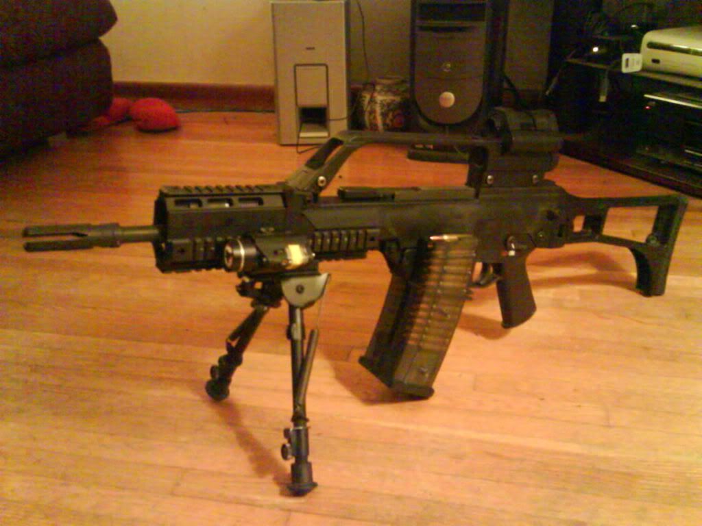

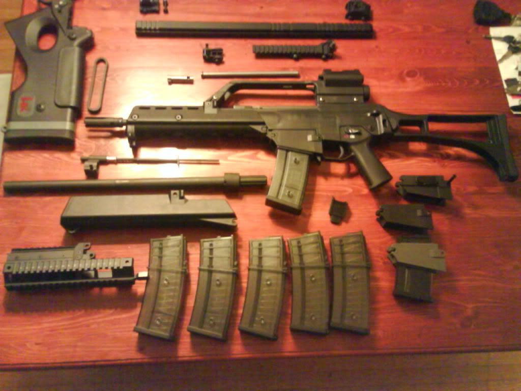

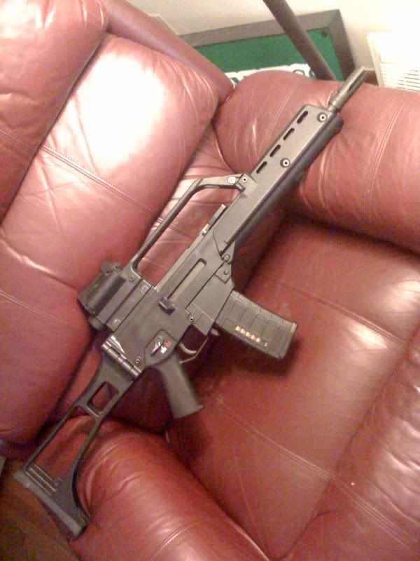

Took me about 2 years to finish. Pheew. Now Im thinking on selling it to fund a Bulgarian Krinkov AK-74su in .223 and to finish my AR-15. Both will have to be on a Form1 (short barrel rifle form or SBR). Also thinking on getting a Sound Suppressor for both mentioned.:rockOn:
The question of model variation has come up. I don't know why I did not think of putting this info here before. :redface: So now I have included it:
